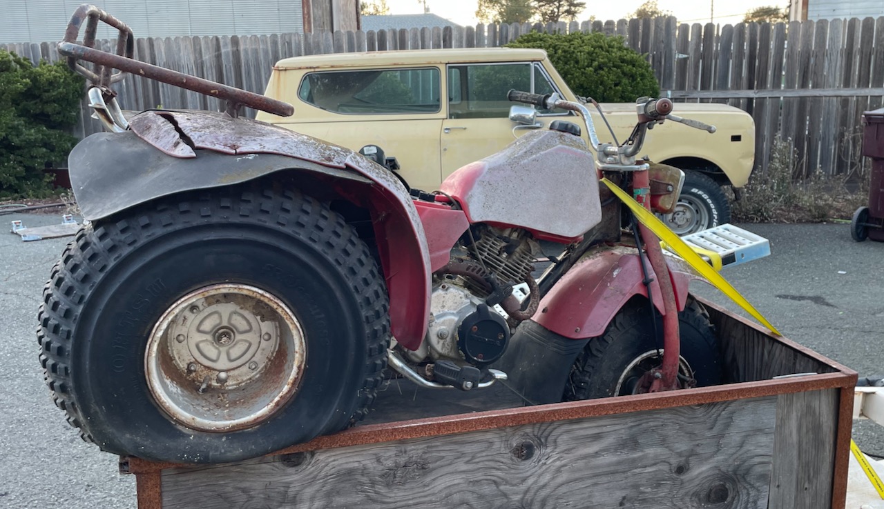

    This poor thing was left out in a field for the last many, many years. Well, it followed me home the other day.
Name:	atc200 - 1.jpeg
    Upon inspection found it was making spark and building compression. The OEM carb and fuel valve did not like their long stay in the field. Ordered up a new carb with a new intake manifold and fuel valve that night. Of course when they arrived the intake was wrong. Found the correct one and finally got that in the other day. Fixed the pull starter (just a quick cleanup did the trick) Cleaned out the tank, it had huge chunks of what used to be rubber, and glue like fuel. After many many pulls found the spark had left, turned out to be a loose lead at the coil. And the next pull she gave the good fart sound, and the next pull or two she was running. A quick tune on the China carb and all is good.

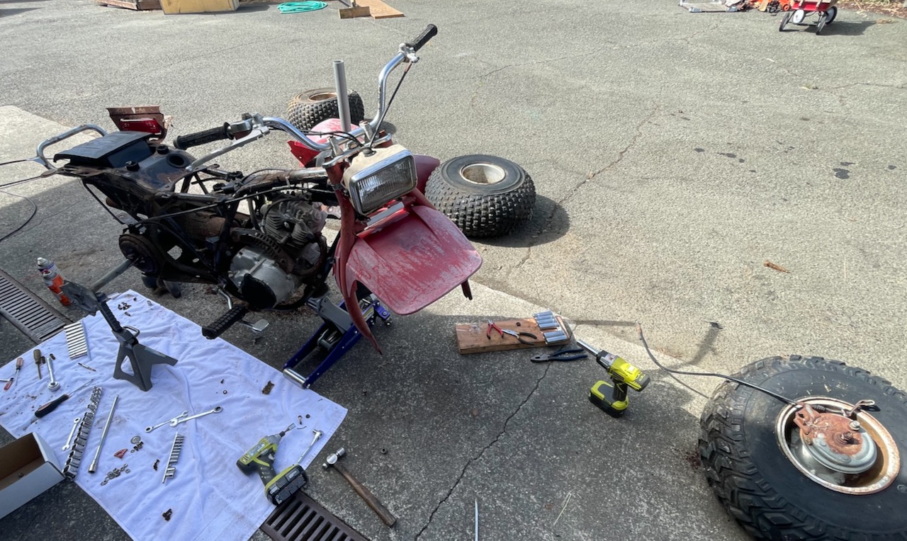

    Brakes are functional once I get some new cables. Electrical is working. (have not checked the lights) And 1 out of 3 tires holds air, 2 out of 3 accept air. LOL I have the split rims on this so decided to give some tubes a try in the leakers. Also have a brake handle ordered up. Clutch seams to be working fine, but chain is shot... Can't imagine why looking at the photo.

    So yea, chain ordered up too. Thank that is about it.
    I have no seat pan for this thing. Anyone have something? Worse comes to worse, I think we can make something up that can pass for a seat. Heck, it will look about as nice as the rest of the machine.
    Sad, I don't think this thing has a lot of miles on it. No idea why someone just left her out to die from exposure.
