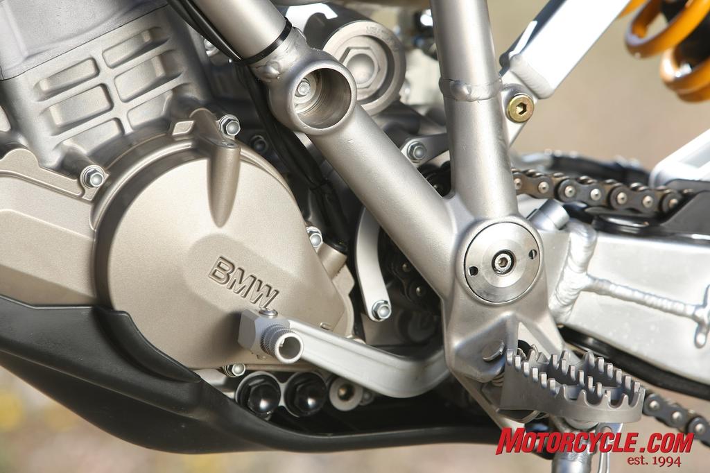

    The only way to have a chain that doesn't go through wild swings in tension as the suspension travels is to put the pivot inline with the output shaft. That is a very uncommon design, because it has it's own issues, and pretty much is something engineered from the ground up, not a modification that could be easily done.
    Here's what that looks like.
    Here's a few words about it.
    https://www.motorcycle.com/features/...0x-review.html
    Perhaps the single most impressive design element of the G450X is the exclusive implementation of a coaxial swingarm pivot/countershaft. A hollow countershaft serves as the swingarm pivot bolt hole, allowing the countershaft sprocket to rotate around the swingarm pivot point. This completely eliminates the need to adjust the chain to accommodate the wild variations in tension due to 12 inches of rear wheel travel. It’s a surprisingly simple solution to a problem that has been the bane of long-travel suspension since its introduction over 35 years ago. It’s ironic that BMW would be the first manufacturer (not counting start-up MotoCzysz) to implement this ingenious design.
