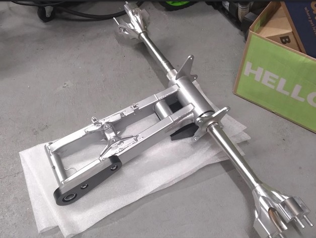

#2 the axle sprocket hub assembly's are always worn down and loose, it was a stupid design again. I have a 300ex axle fix but that requires being able to weld. I can make weld on sleeves and the rest if up to you.
