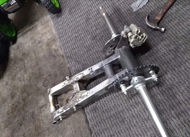

    300EX AXLE in 1st gen. I turned a new carrier and cut the old one off, you don't need to if you machine weld on sleeves for the seals. I've done this swap many times and so have a few friends. Who does not like a nice beefy axle swap.
