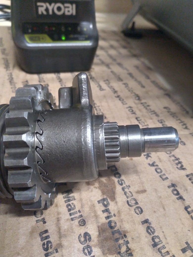

    Yes I can do it. Its a process but its a sweet one. Will look like this when done. I use to offer the service on ebay and got to much biz. It takes me about 2 hours. Do i make much money...nope. I make more at my real job then side job. But low labor rate side work keeps guys returning.
