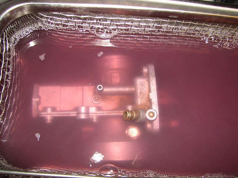

    what is that machine called?
    Nov 2010
    Warwick, RI
    66
    It’s an ultrasonic cleaner. You can pick one up at Harbor Freight for about $30, granted it is not as nearly nice looking as the one above.
