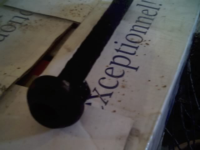

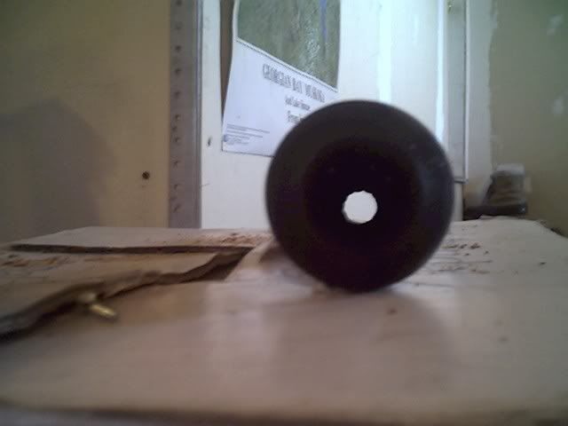

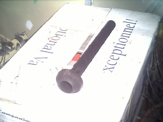

    So, I was letting my 200X warm up while I put on my helmet and gloves, I get ready to go on, pump the throttle a couple times to see if its all good, it was good, until the 3rd pump, RPMs go nice and high, and boom, the freaking silencer just slides out the back of the exhaust...at first I was like WTF is that, then I take a look at the exhaust and notice its 100X louder then it was previously, so I kinda figured it was the silencer...In my opinion its to loud to ride, I can handle it, but all my neighbors would complain thats for sure...if your standing beside it, with not even half throttle, your ears will be ringing for the rest of the night...far to loud to ride...although, I did notice its a little bit quicker off the line ...What should I do now? Get a new exhaust or repair this current one, mind you this one here is full of exhaust sut (or soot) and seems relativley easy to repair...I beleive the previous owner put this exhaust on a couple years ago,
    So...Repair or buy new one?
    Some pics of the silencer
    ,,,until the silencer falls out and its to loud to ride, safely

    clean it put it back in and get some metal screws and screw it back in or you could drill and pop rivit it etheir way is good but dont ride it too long without the back pressure you might melt something

    So its ok to just put it back in? theres nothing else to it? jsut put it in a re secure it? sounds easy enough...thanks

    A couple self tapping sheet metal screws should handle that fine.

    Is that a Cobra? Hey dont forget the stuffing..

    Jenns right that is a cobra, it should be repacked before being put back in.
