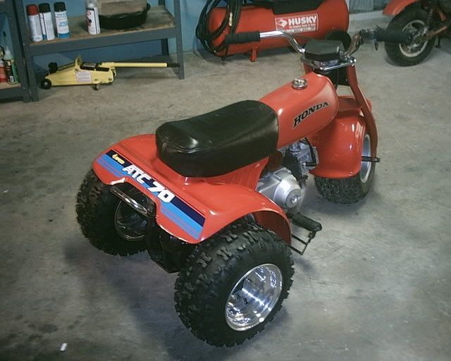

    www.douglaswheels.com have got back in touch with me, and want to know the details for the ATC 70 douglas wheels. If they don't know. Who the hell does. I gave them the year and a link for the ones that are being sold on ebay, and they still can't help me.
    This what they have just sent me:-
    "We do not have an application for a ATC 70 therefore I do not know what wheel you are needing. I have attached our application guide for you to reference from".
    I can't understand this excel document they have sent me. So all I need is the diameter x width and bolt pattern, then they can sort me out (hopefully). If someone who has got these wheels give me the details, so I can forward them on?
    Thanks
    John

    I think you are going to find the ones sold on Ebay are 8", with low profile tyres fitted, thats what it looks like to me, if anyone who has these rims can just tell you what the tyre size is that is stamped on the side wall this will probably confirm my theory.
    As far as I can tell no-one makes a 7" alloy rim to suit the ATC70. However I'm still trying to confirm this.

    The TRX70 rears were 7x6 3/100. Im almost positive ATC70 was the same.

    I second that ..... ITP makes them.

    ITP make tyres don't they, or do they make wheels aswell? Do they have a website?

    I have the ebay alum wheels sold threw inland atv the tire size reads 16x6.50-8,my stockers that came off where 16x8.0-7
