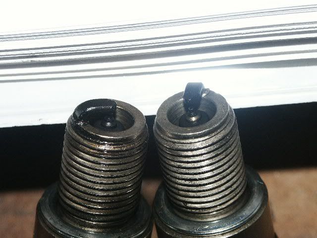

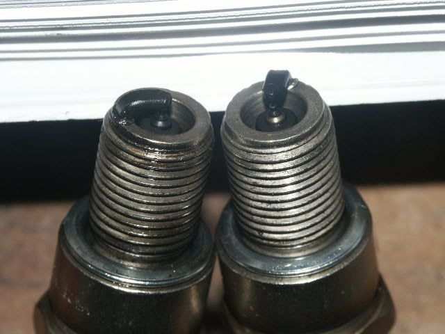

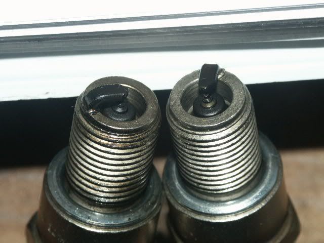

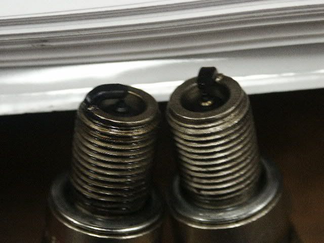

    Here are pics of the plug I fouled along with the good plug from when I pulled the motor.
    They both look rich 2 me!!!???

    yes, they do. i've been told that at higher elevation you use smaller jets, thats why a bike jeting in CA, will never run right in NJ. do you have the airbox lid on?

    I would leave it the way it is and do a couple plug chops with a new plug. That will help determine where or what to change. Try one at half throttle then again at wot.
