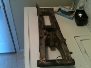

    I just got done doing a +5.5 on my x, its not very clean looking but very strong(i hope) I used another junk 200x swingarm and a doner to get more length since I couldnt find any steel that would match or incase the size honda used. I cut a section out of the old one 5.5 inches and cut my good one in half. Tacked it up and got it true and stright then I reinforced the hell out of it with some steel strips I had laying around at work. Im having a 350x shock built shortened to give the rear end more lift. I building a lifted atuo x.
