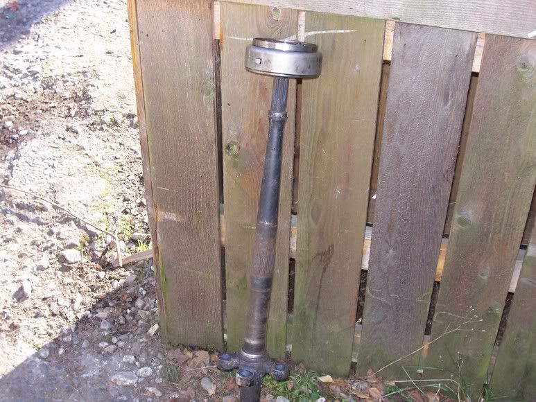

    Anyone have a part number or what type of puller to yank the flywheel off a 250sx? I am tearing one down to salvage some parts and none of my pullers are working for me. I really don't want to ding up the flywheel with my jaw puller.

    Oh Sh!t, I forget exactly the thread and pitch but simply put, it is just a bolt with somewhere around 20mm and I think a 1.5 pitch. The pitch is an odd pitch for that large a diameter.
    I've tried every friggen bolt I own in that sucka, theres always something. lol

    I think the dam axle threads from a used axle fit perfect, I may have used a stock SX axle at the time - I forget, now I have the threaded stud. But if you have a spare axle around, throw some vice grips on it and have a ball!!
    Quote Originally Posted by Dirtcrasher
    Lookie what I got! thanks a bunch Dirtcrasher 350x axle works duckie

    LMFAO!!! I have seen front axles used for flywheel pullers before. But this is a first right here!!
    People this here is proof that having spare parts kicking around can save you money.

    Awesome, glad you had one laying around. When I discovered it I had my ex fiance' holding the motor on the bench while I was holding a 3 foot axle trying to break it loose, we almost knocked the motor off of the workbench,LOL. It's all good.....
