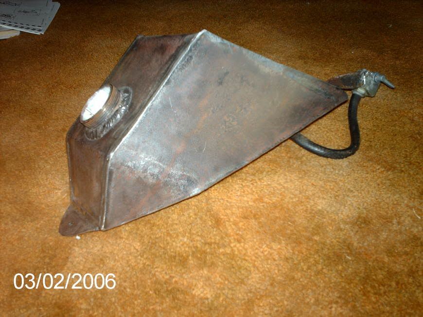

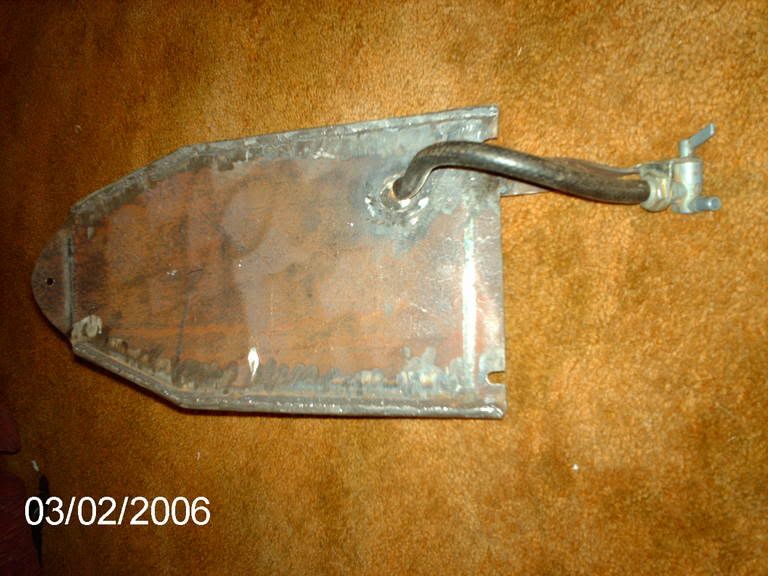

    Quote Originally Posted by jsimonh
    Here is the tank before I did some serious grinding on it. I wish I would have had the camera to take pictures of the actual building . I have made more progress today and will post pics later. Hopefully this coming Wenesday I will be able to put the final welding on it. I also ordered some Red-Kote for it today. I'm starting to get really excited about it!
    Can you post more pics? I want to the see the cap and the bottom. And everyside possible, Im really interested by this.

    A little update.
    All the welding is done and most of the grinding. I'm pretty much at a stand still untill my Red-Kote comes in. I plan on doing the coating before I do any of the putty and painting. I wouldn't want to ruin anything or have to be super careful when doing the coating.
    No pics of it on the trike yet, hopefully real soon.
    Kintore the neck of the tank is just 2 inch steel pipe. Alny pipe cap will work, but I'm not sure what to use yet.

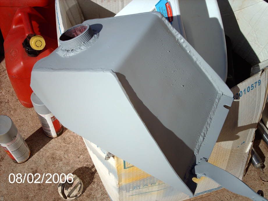

    I had a little trouble with the Red-Kote. I put it in (1/2 quart) and then realized that the neck and the drain tube both have small necks that extend into the tank. I couldn't get the excess out so the drying time has been very long. Today everything was set, but it is not completly dry yet. I went ahead and cleaned it up and put a layer of primer on it. I think its looking pretty good. I'll post more progress later.
