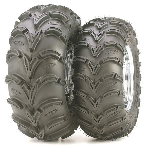

    I run 20:1 in mine and is jetted for 3300 to 6600 feet. It runs great, no fouling and barely smokes when warmed up. I use a good quality petroleum based old school 2 stroke oil.
    As for tires, I have been running these ITP mud lites that work great for all terrain from trails,sand,snow mud. They are 6 ply tires.
    I thought they would be rough but actually quite smooth.
