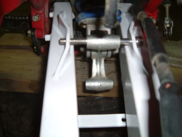

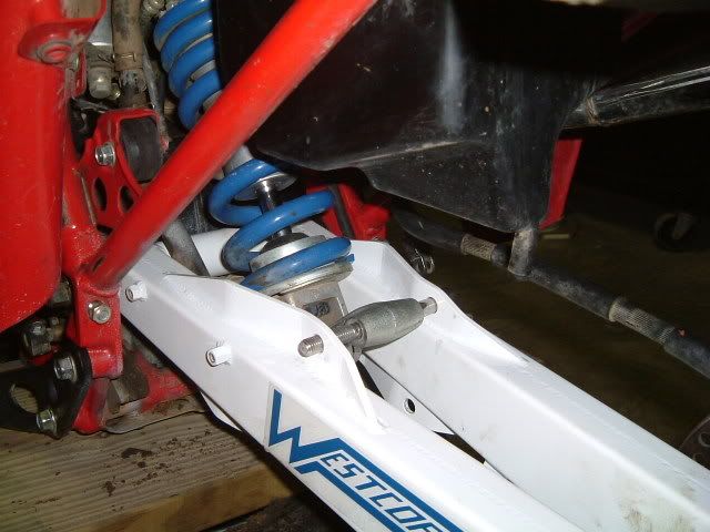

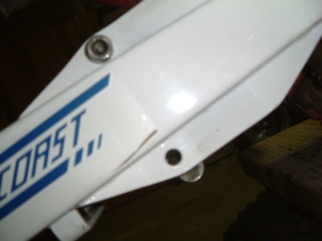

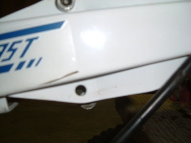

    Ok here are the pic's. What do you think? The bottom bolt hole is off by at least 3/8 of an inch. Do I need to make one or do you think another year shock link will work?

    i see. i would just cut and reweld the factory one. that is different then mine but i know there are some 200x westcoast owners on here.
