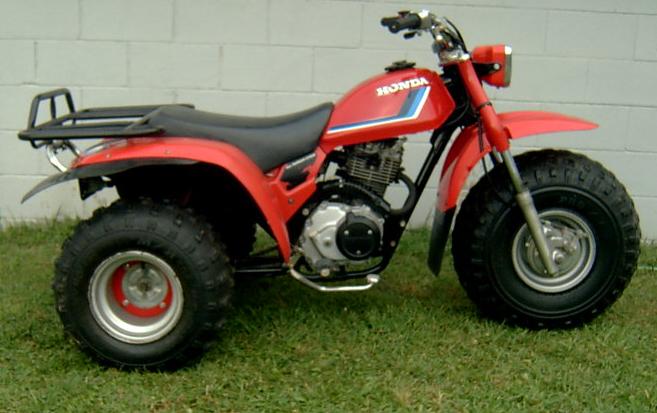

    I have 20" rears on my 83. I don't ride it much anymore, but man, it takes off like a jack rabbit with these small tires:

    Hey ATCTIM...Your bike was the one I was looking at.Are these stock rims?I am planning on doing that to the exact same bike.

    burnoutboy,
    Yes, those are stock wheels, and those tires are stockers off of a 300EX. Hope that helps!!
