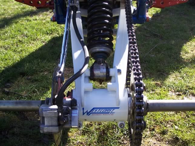

    Quote Originally Posted by Dave223
    I have an 84r, and from searching around, I found that swinger parts are non existant or very pricey!!!
    What parts do you need?

    Sorry, but I'm using it...lol. I was just wondering which particular componets you need to revive your swinger?
    84'R pic page; http://magoos.wheatfarm.com/pictures/index.php
    I have a RAD double row in my aircooler... Xststem makes new poly bushings for the pivots which eliminates the collars and needle bearings...
    http://www.radmfg.com/carriers_double.htm

    hey troll,
    I will trade you my wife and 2 kids...all have good backs and good eyesight! Nahhh JK...ok no Im not....why did you have to show me that????? YOU TOO BLAZER!!!!
    I didnt know about the RAD carriers, thanks for the link....and does XSystem have the kits ready for the 84s yet? If so I didnt see the thread...man oh man, I need that kit.
    Troll, whats the measurement from hub face to hub face on your axle? I measured mine today and came up with 33 1/2" Dave

    .Dura-Blue Axle;
    It's about 38" wide and dia. is 1.180 at the smallest and 1.380 ( axle dia. not collar)
    It didnt look like that when I got it....lol
    Dads got me some bearings http://www.3wheelerworldforums.com/m...p?*Edited*=691
