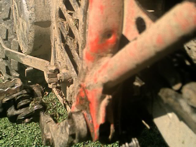

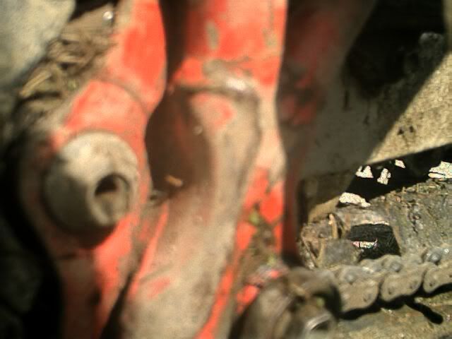

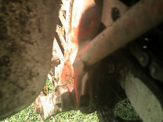

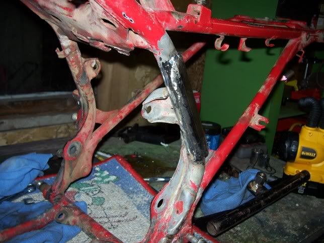

    these frames are incredibly week on the left side...
    This is frustrating, its allready been fixed once with 1/2 inch water pipe, and now it breaks here!!!!

    A good friend of mine has a really nice 85 350X and he found a crack in his frame on the same side but a little higher up in the sub-frame. he took a piece of steel cut it into a diamond shape and he "diamond wrapped it" as he called it. he is a phenominal welder and fabricator when he wants to be when he is away from his job, thats all he does at work.

    weird I have a 350x frame that has problems there too, but where the left foot peg mounts is nearly rotted away.

    i cut a peice of steel in the shape of a triangle and welded it in the joint. so far so good.

    Yeah thats what we did to my orange bike before I had it powdercoated, It was real small and looked it over after I had taken it apart, but I hit it with the sandblaster and found it, we ended up grinding the crack, welding it up, and fishplating a diamond shape piece of tubing over it... I even ground it down a little and smoothed it up with JB weld, the powdercoat stuck to it just fine....

    That better not ever break, thats a rap around 1/2 inch water pipe welded on
