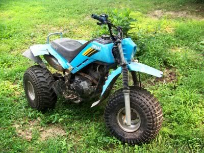

    And how can i line up my handle bars/forks...i gotta turn right to go straight

    yup somethings bent...but its bent towards the back and there twisted to the left
    do they line up by there self?
    do i need new ones?

    Post pics so we can see the problem. lol

    here's some pics

    your forks are the problem. they are twisted all to hell
    looks like you need some serious air pressure in the left tire too.

    forks are bent man. You might be able to straighten them after you get them off...

    Those forks are junk.Don't bother trying to fix them.Get some off of egay.
    That poor thing.
    The stock exguast system looks to be in good condition.
    Thanks for the pic.
