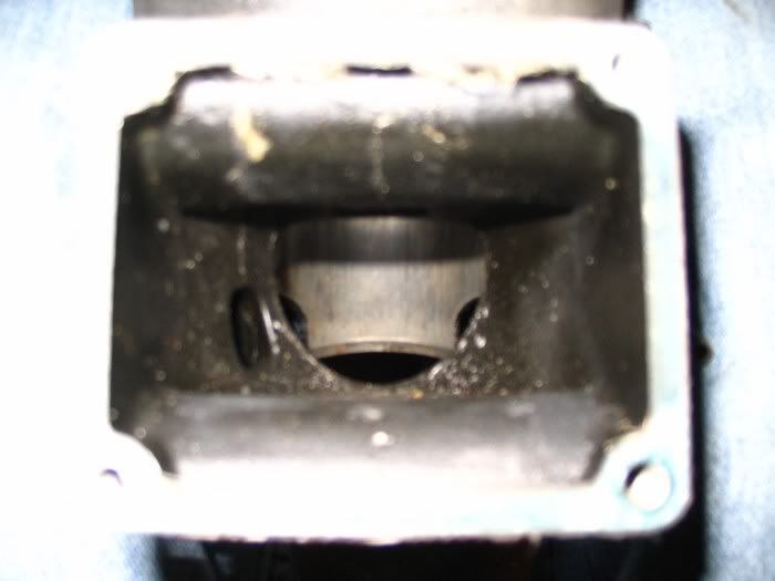

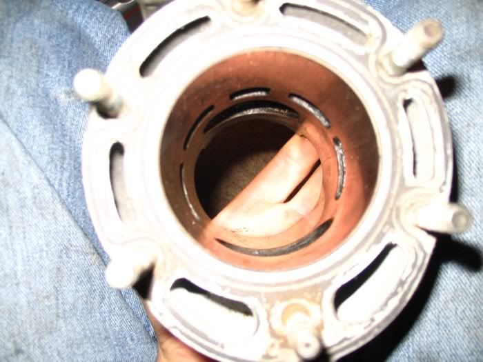

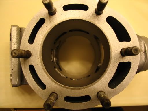

    YAMAHONDAMAN ported cylinder pics!

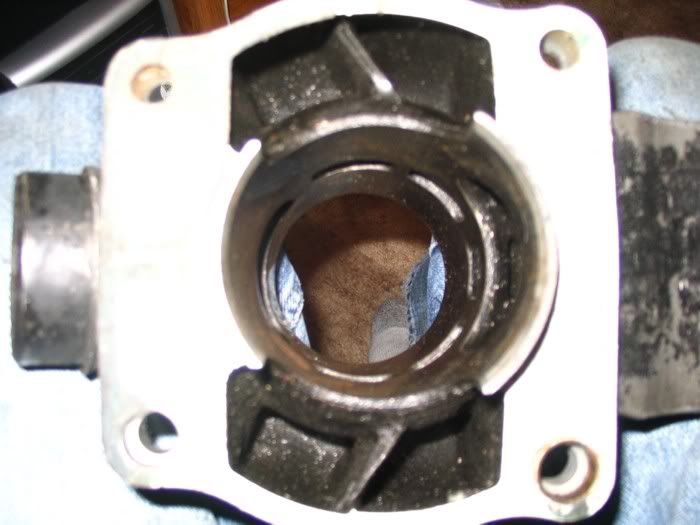

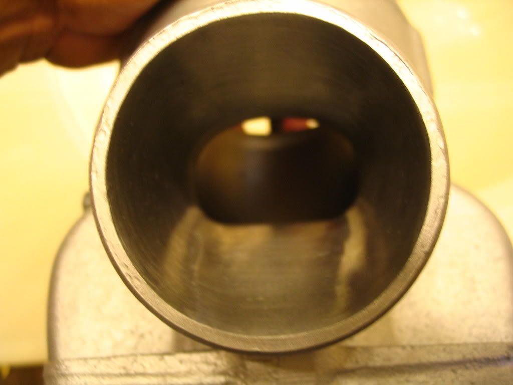

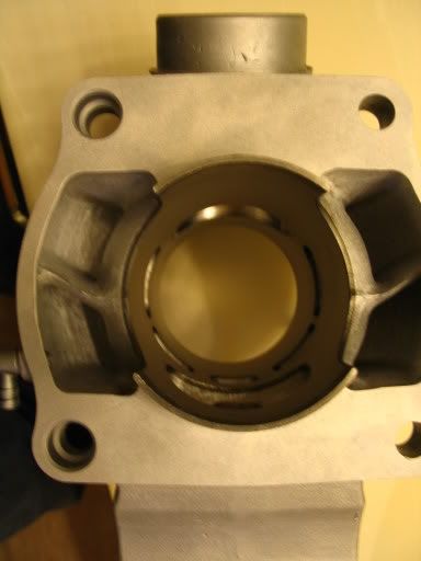

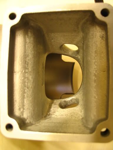

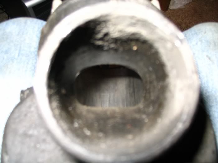

    BEFORE
    AFTER
    BEFORE
    AFTER
    BEFORE
    AFTER
    BEFORE
    AFTER

    $100 +shipping both ways.

    MX Port. I cant wait to get this motor together, I need all bearings, bolts and powdercoating.

    ok ,,, i see port work ,,, now i ask ,,, would it be better it you sleeved it and split the exhaust port so it could be wider ????? wide single exhaust ports grab rings,,,, just a honda guy thinking of ways to make a yammy better...........................................

    that second boost port looks real nice ronnie.that thing should rip nicely.
    Heck i wished "i need" to do more to the TRI-Z's But............ WHY ??
    ( They ) Run me with the FIVE HUNDRED'S Now !!! if i did any more......
    i would have to run with the "Busa's" in the 1/4 !!
    maybe next year........ after TF07 ...........i can go "WEST" And race some
    Honda 250's !!!

    If you bevel the big wide oval ports enough the bridge isn't really as necessary was you would think. Its just important that however its beveled is gradual where it doesnt let the ring just jump out and then slam back into the groove.

    ok .......... you know about TRI-Z Power i assume ?? Kinda like Banshee....
    NO Bottom , some Mid and then ..... TOP ..... "they" call em the "Light Switch" Power Band (s) ... the Honda ATC-TRX ..."on the other hand" Like Kasey implied.... "why don't you re-sleeve and make the Exhaust WIDER ?????
    Because ....... "re-sleeved" Cyl's has NEVER and WILL NOT Run like the Stock O.E.M. Sleeve.. been there ...... done that..
    ....HONDA Cyl's. are MUCH Different than Yami.... the YAMI Cyl's can be Ported MORE then the Honda Cyl's...
    Darius..... on the Porting TRI-Z Thing ....... NO Low end is Lost ....Just BETTER Mid and MORE TOP !!! when you Port a "Honda" ...Low end is Lost BUT.........
    Not Noticed !!!
