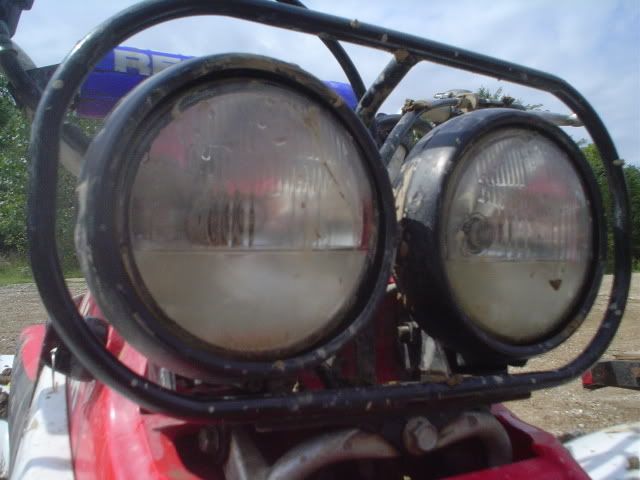

    Last weekend my brother did a similar thing, on my bike. He rode off a 15" embankment by accident, and did a front flip into a lake with my Warrior.
    Heres an aftermath pic..........

    LOL! That reminds me, how do you get the water out of the headlights? hehe
    I made my brother dismantle them. They are in the garage right now in front of a fan......
