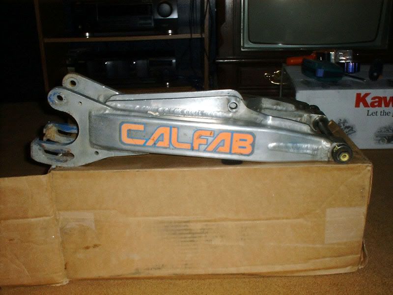

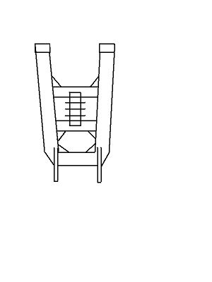

    Here is the swinger I plan to build. The middle will have a backbone like the pictured Cal-fab that will have three different shock mounting locations. The front will be stock ride height, then by moving to the mounts further back you can lower the ride height to match lowered forks.

    If your doing all the work to make a new swingarm then think about making it like the 400ex and using the 400 ex bearing carrier. The you can get new axles etc.

    The swingarm wall thickness should be .125 to .187 of an inch. The dimensions should be close to 1.5" x 2.250" by the length. See if anyone around you has the rectangular aluminum stock, if not let me know. We have an aluminum supply company that sells drops and doesn't mind cutting shorter pieces. It running about $3.00 to $3.50 per pound for 6061-T6.
    The one I'm making is solid with milled pockets to reduce the weight and increase the strength. It'll be a little heavier or close to the stock swingarm weight. I saw the design of yours and the Cal-Fab, looks good.

    Bigbore, I plan to use steel for the arm unless I can get a good deal on aluminum locally and weld it all up at the college.
