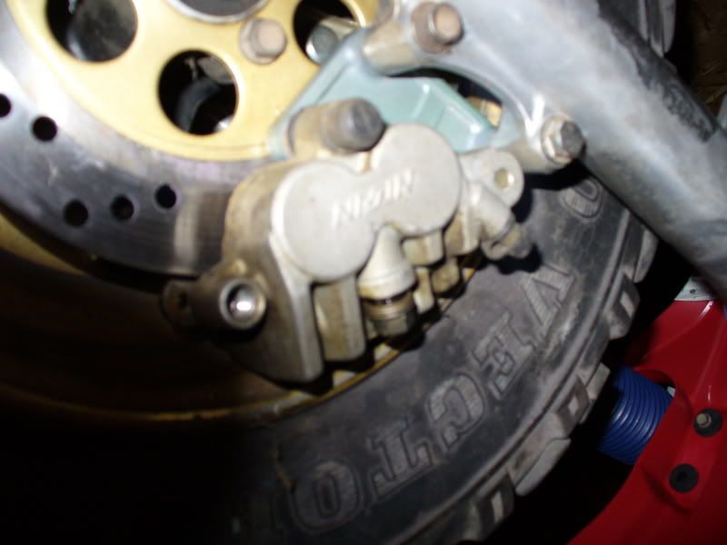

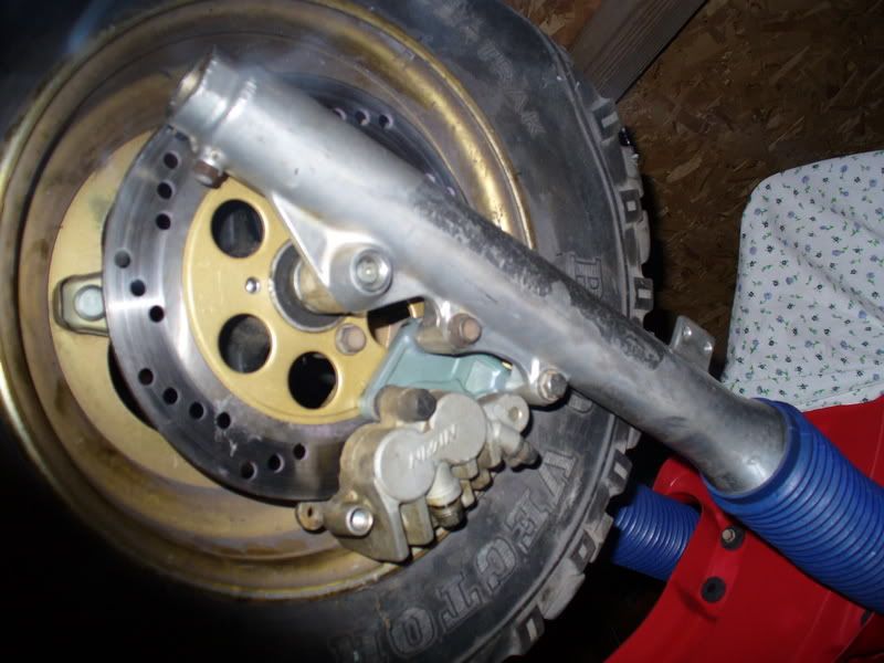

    I posted a couple questions her about whether a CR caliper would work on an ATC 250R. Well....it does indeed work! I got the caliper today (listed to fit 97-99 CR's), and started looking at things.
    I used the stock 250R bracket, and it was a done deal.......almost.
    If you look at the pics, you will see the slider pin right by the bleeder. It threads into the caliper. This slider pin is too small for the hole in the bracket, so I did some machining.
    I made the hole in the bracket a little bigger to accept a bronze bushing, which I machined to make a nice fit on the pin. Now things are perfect. That is the only thing I had to do. Otherwise, it was a bolt-on deal. By the way..in the pics, it looks like the caliper is tight to the rim. It isn't much more than the stock one, but enough that I don't think a 10" rim will fit, even with some fin grinding.
