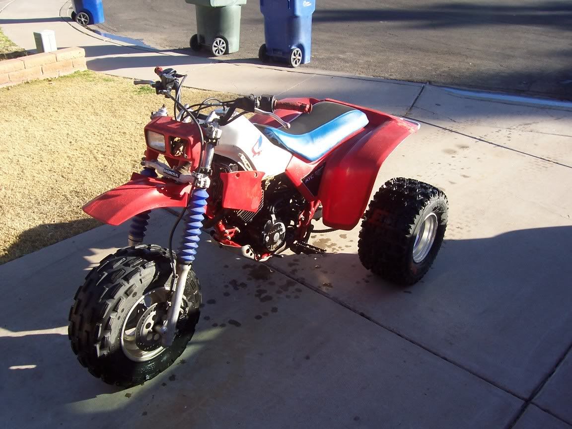

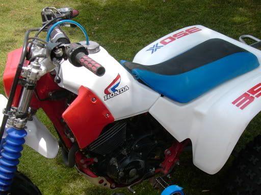

    ive always done automotive paint and if you get the reducer just right it comes out like glass with no need for a clear coat. here my 86 350x tank i just did.
    Before
    After
