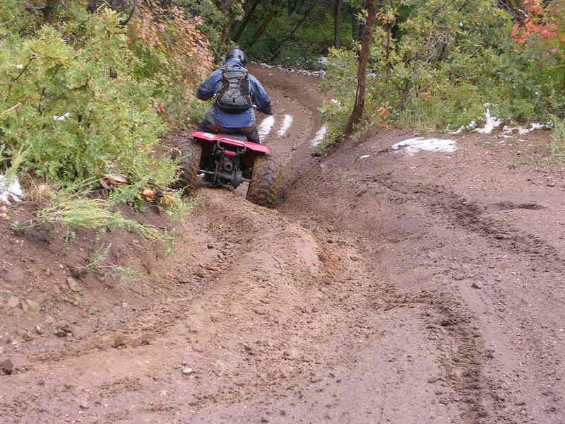

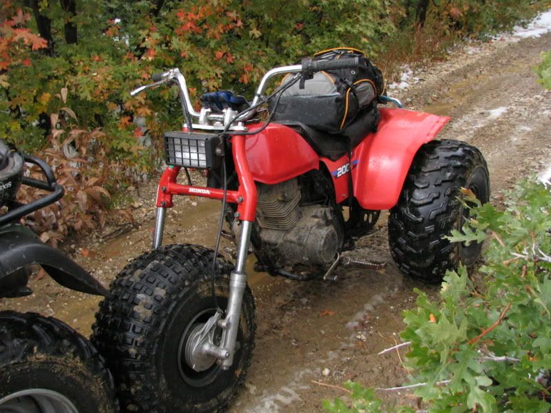

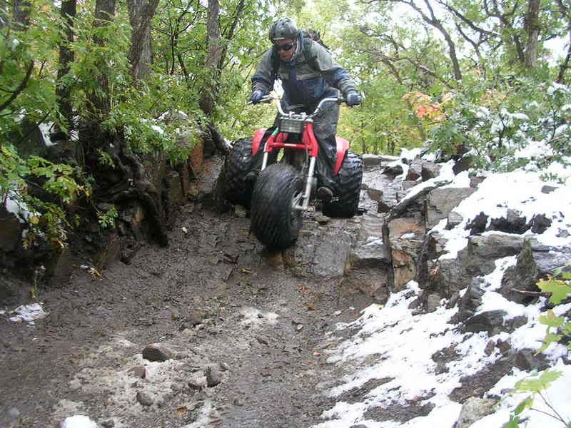

    I run 25's on the rear of my 200S. 22 on the front.
    I like 'em!
