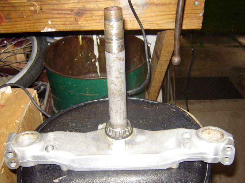

    Well I worked for about 3 hours today on the tripple trees, the major problem was that the 200X used regular berrings and the YZ used tapered roller berrings. The switch was not to bad though, all I had to do was drill out the roller berrings by.042 to fit on the stem. I lucked out though, the stem happened to be the perfect length.

    so tell me how you drilled out a bearing race???? its twice as hard as tool steel!!!
    Apr 2006
    Miami FL
    47
    Dremel and a Die grinder. .042 was a bit of an exageration. lol

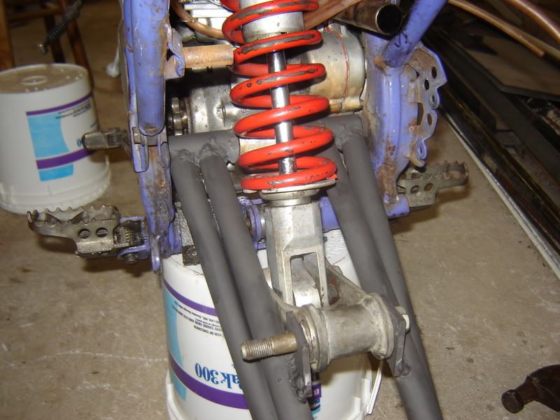

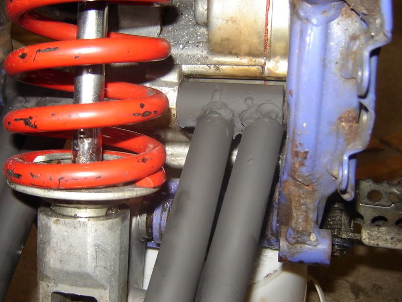

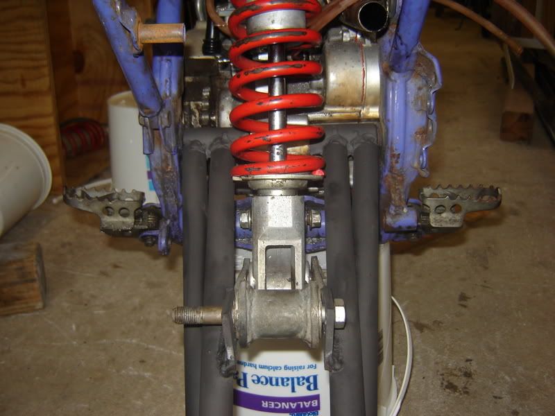

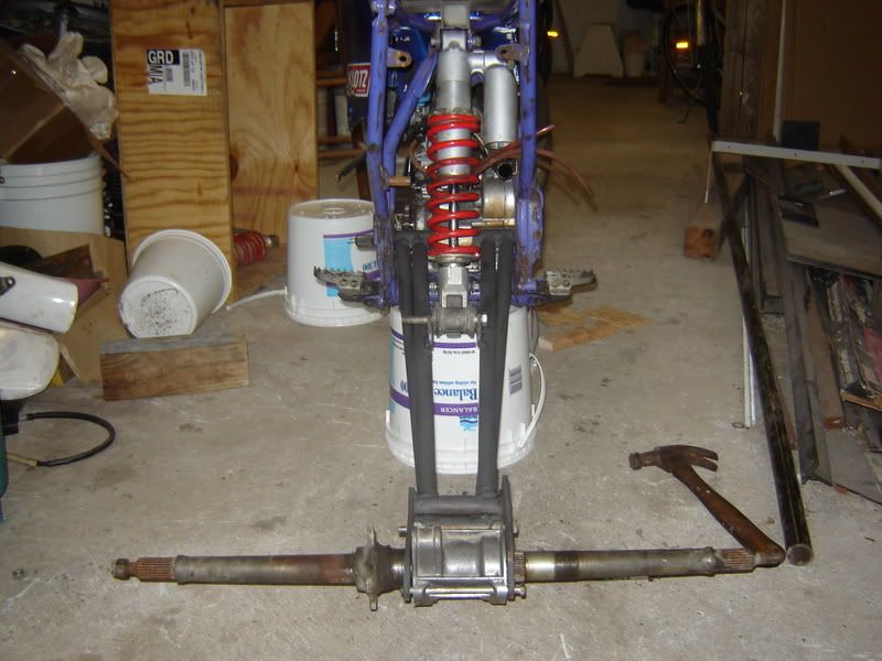

    I had a day off school today so I finished the swingarm, I was going to retro fit the one I had but I decided to make a new one. Anyways here are some pics.
    http://i25.photobucket.com/albums/c9...irtbike020.jpg
    http://i25.photobucket.com/albums/c9...irtbike021.jpg
    http://i25.photobucket.com/albums/c9...irtbike023.jpg
    http://i25.photobucket.com/albums/c9...irtbike022.jpg
