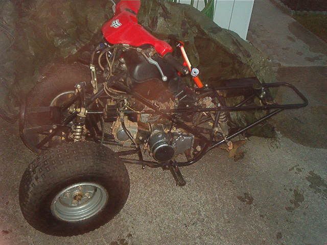

    I cleaned out the tank and the carb-was nasty! The pilot jet was totally blocked up. I got it to idle pretty good, but wont really find out till its been out riding a bit. The air cleaner was horrible too. Found a crack where it looks like some dummy tried to adjust the chain without loosening the right bolts so im gonna get a used swing arm for it.
    Those folks beat this thing, and its a 2000! Plastics cracked, mounting points bent etc. I should be up to about $700-$800 after getting it all fixed up, not bad. It doesnt smoke at all. I will post pics of my progress, I almost have the swinger out, was thinking about welding it for now, or I could really drive as is but...

    I found some cracks around the the rear swinger and axel so Im pulling it all apart, Im stuck at the brake drum though. Everything is apart except I dont know whats holding the drum on, can you look it up for me?
    And what they recommend for pulling the sprocket mounting hub too.

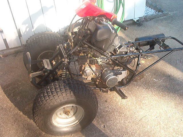

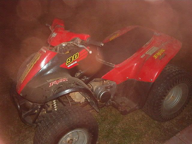

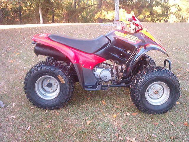

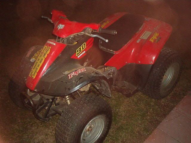

    Before: running good like hondas do even with all the issues, just not idling, paid $600
    During: rebuilding rear end, cleaning it, etc
    after I pressure washed the 1inch layer of crud off it
    After: cleaned out DIRTY carb, drained the bad gas, put new rear axel carrier and swinger (had some cracks) off ebay for only $50 total with shipping-NEW. Labour to pull out stuck on axel and change 2 tires at this rip off ATV joint was $115. (they over charged me, they charged me $10 for a "shop fee" they explained was the tire lube (when I worked at a shop our "tire lube" was soap and water, so I guess this was top of the line tire lube they used, and they charged me $10 to get rid of the 2 good [just too big] tires that were on it that I had to get that removed and took my tires that they would probably just resell anyway...). Added two NEW Hole Shots that I had laying around from a 3 wheeler project that I sold off-$90. Changed the oil, pealed off the dumb stickers, cleaned the air filter, replaced missing bolts, fixed dents, painted as needed. Runs awesome but still needs a few things, carb runs a tad rich and needs to be tweaked. Total cost not counting tires was under $800. Plastics are beat though and it still needs some stuff.

    I think you got a real bargain. Looks great.
