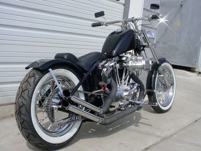

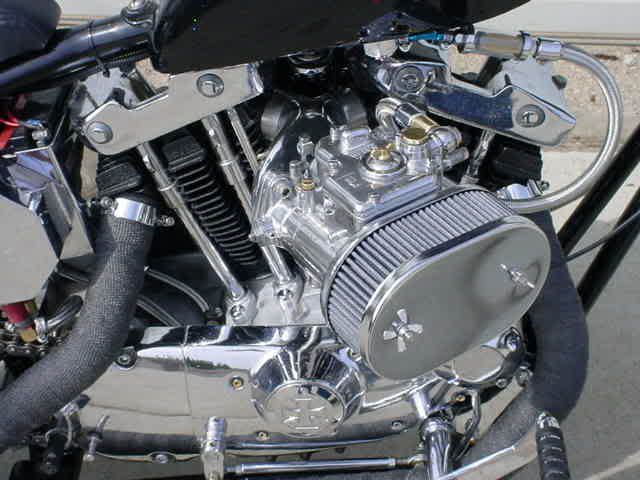

    first pics are of the dual throat 40mm Weber carbs on my 1971 Harley. i went full out polish crazy on it since she is my baby and ya, thats me with beer in hand so ya all can see how ugleeee i am !
    other pics are of the recent Mikuni 34mm i did for the 125 Tiger, and another pic of a 185s / 200s Honda carb i did the other day (which is for sale. it is about as perfect to new looking as you will ever see, i didnt show the inside but it is flawless like new as well).
