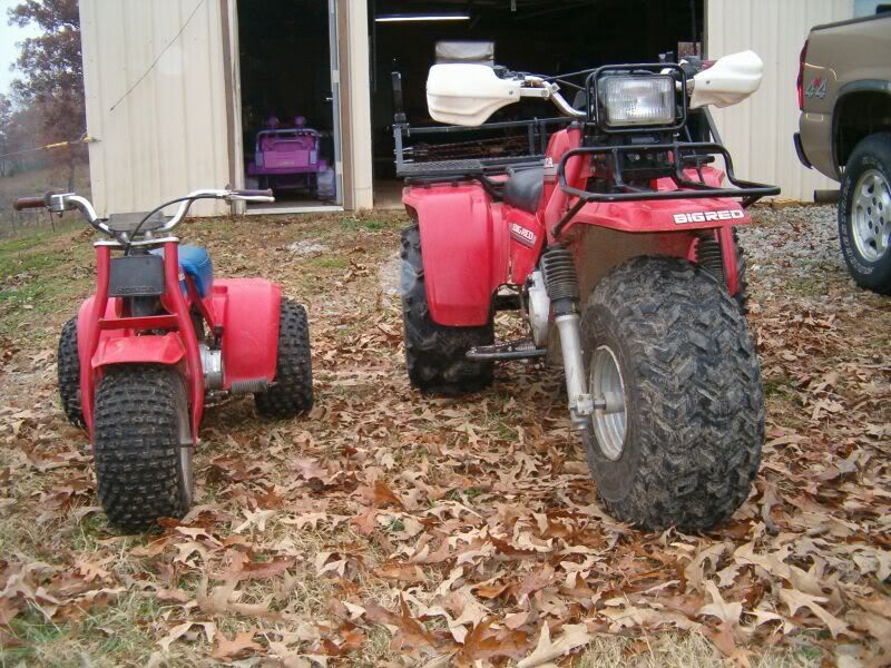

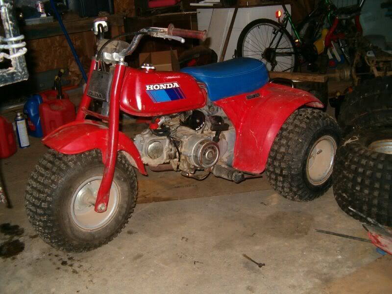

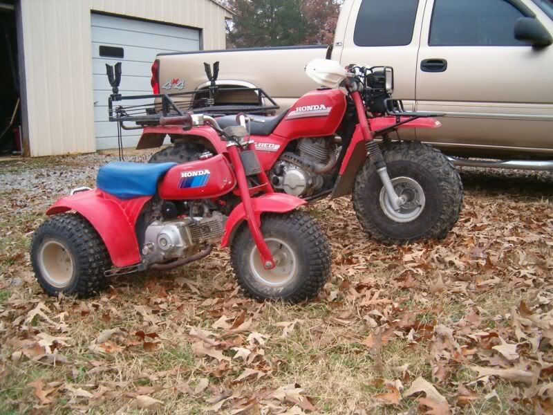

    Finally got a 70!
    I've been looking for one close here for a few monthes. It's for my daughter's 5th birthday in December. I can't wait for her to see it, I've been sneaking rides in the yard with it when she's not paying attention.
    Today I rewound the recoil spring and new rope, cleaned the carb out, drain and filled the gas, put inline gas filters in, changed the oil, new plug, cleaned the airbox and filter, and she fired right up. It had been sitting for a few monthes and needed some TLC.
    Should the chain cover have some oil in it? It looks dry. Or do you just lube the chain with spray oil through the cap in the back? And where is the chain adjuster at?
    I weigh 210, am I gonna hurt it? hehe

    Nice one I have one just like it.You tighten the chain with the tensioner.Its a small sprocket ,you loosen the nut on it and move it in the slot to tighten the chain.I had my side covers and the chain cover off so many times fixing the stator I dont remember exactly how to tighten the chain with it all together.Just get some sticky chain lube to lube the chain up while you are tightening it.
