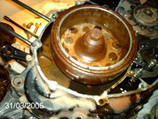

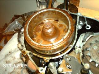

    Well I started to take the side cases off. One side has a bolt broke off where the oil filter goes. It was like that when I bought it and oil leaks out of it slowly. The other side is coming off because of a slow leak at the shifter plus I have to take it off to put the new flywheel on.
    When I got the flywheel side opened up I seen a horrible sight. I don't know how this happend, but look at the condition of the stock flywheel .
    Will a normal metic bolt work to get this flywheel off? I have read that you can use the axle, but I only have the one and I'm not wanting to take it out. Any ideas why it got so rusty?

    20 yrs. of condensation. Not that unusual.
    Thanks for the insight . When I did my old AutoX and TriZ, and just recently the Tecate none of them was like that, so I didn't know they could get that bad.
    What I do know is that the rust isn't helping to get the dang thing off!

    Lookin good so far. Sounds like your engine already had some work done to it previously. For the flywheel i used Oil filter remover to hold it and an impact to zip it right off. Watch out i think it might have been reverse threaded.

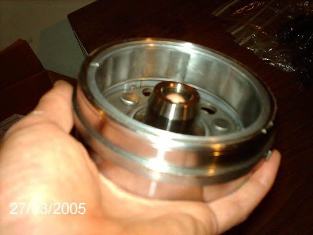

    I just got back from the farm, where we were able to get the old flywheel off . I noticed that the inside (where the magnets are) is smooth, and the one I had lightned seems to have small ridges. They are constant all the way around and the same length apart, but it isn't smooth to the touch. Any thoughts?

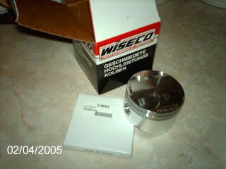

    Ive ran accrost several flywheels like the one you had lightened. They work fine, but i am not shrue of the diffrence yet from the others. With the oil in your flywheel area i woudnt worry about, who knows where it came from or how long it has been there. Rember you still have that option of having me port your engine. but anyways looks like everything is going somewhat smooth, but with that 12:1 piston you took out it probably would have been a good idea to run race gas.

    Well the guy that I bought either didn't know about the piston or didn't think to tell me about it. Do you think the one I just took out is a 12 to 1? My new piston should be in today and I'll be able to compare them. On the porting, if I decide to do it I'll give you a call . I don't think that's a mod I want to mess with right now. My deadline is this coming weekend so I can hopefully attend a trip to Little Sahara.

    I'm not sure about them Ridge Things in the Fly Wheel...maybe a diff. yr. ?

    That's what I was thinking, but I don't know. It has strong magnets and seems to be real solid so I'm not worried about it, I was just curious.

    As long as the inside Dia. Don't hit the Stator........ GO FOR IT !!!
