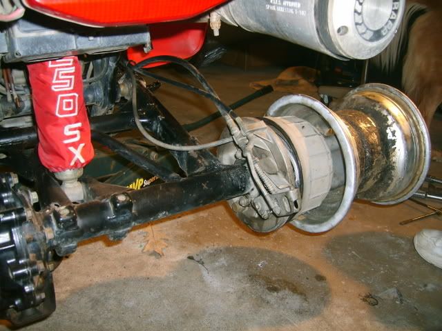

    So after posting a thread a while back I was told that stock 9 in. 400ex rims will fit my 85 SX no problem.. Well. I finally got them in today and they aren't even close.
    I'm thinking maybe a set of wheel spacers will help being that I'm already $50 in the hole. Anyone have any other ideas?
    I had a few PM's asking if they would fit so I just thought I'd make a post to let evreyone that is/was intrested know that the stock honda aluminum jobbers won't clear the brake drum..
    Live and learn I suppose.

    yep, wish i woulda sean your first post and saved ya some bucks, they gotta be large bell design.

    Dennis Kirks got 4 on 110, 9"x 9", large bell rims with 3/6 backspaceing, they are ITP T9' Pros and they run 68 a piece from them, sure you could find them cheaper.

    Chris, man that sucks. I was told here that stock 200X rims would work on my SX(I'm pretty sure it was wheelie pop who tole' me)& damn if I didn't go & get a set- WRONG!!!!But hey, I recently got a pair of 10" rears from ATCtim that I can't use- I'll send you for what I paid, if you can use 10inchers. do a search on my posts- there's a pic in there. Off subject, but I spoke to Brapp last night, & he said a few of us drinkin' boys oughta ride soon. I'm looking forward to a PA ride!TGG........................................

    You know.. It just so happens that I just now won some 2 1/2 inch wheel spacers on that evil auction site. They should help provide the clearance I need. If they don't the rims and spacers will be in the classifieds here shortly.

    WTF! my 8 inch flat tracker rims that were on my 85R fit on longbed's 85 sx with no problem other than putting some washers on the right side so the rim wouldnt hit the brake drum, bolt pattern on the sx is 4x110 same as the R and almost every other honda on the plannet, you will need at least 1/4 in washers per stud on the right so the wheel will clear.

    More trouble... Now I'm over 100 bucks in the hole. The spacers I got will let the rims bolt on. but it's gonna be way to wide for my style of riding. escpecially in the rocks and such. and now I don't think It would fit in the back of the ranger. I guesw the rims and spacers will be going into the classifieds here in a bit.

    omg I see the problem now!! the shape of the wheel!! My GBC aluminum rims fit becouse they dont dish in as much as a stock wheel does, man I feal terrible, that I told you that they should fit!!man I feal like a slut!! I have an extra set of 8's and if I can get jason to bring his sx over tomoorow I'll see if they fit and send them to ya!

    They will not fit 200X. The studs in the 200X hubs are too short for later OEM aluminum rims.
    You need a large bell rim for the drum brake.
