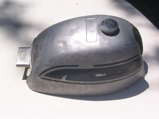

    I faced the same problems removing the decals from a US90 tank - after 37 years the sandblaster couldn't remove them. At the endof the day - the wife came to the rescue - she said, "Have you tried nail polish remover? That takes off anything."
    So I had a look at the bottle and bingo - acetone. Got the bottle of acetone out and within minutes.......
    Before the acetone:
    After the treatment:
    I hope this helps someone!
