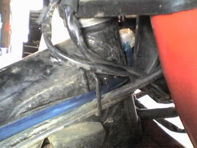

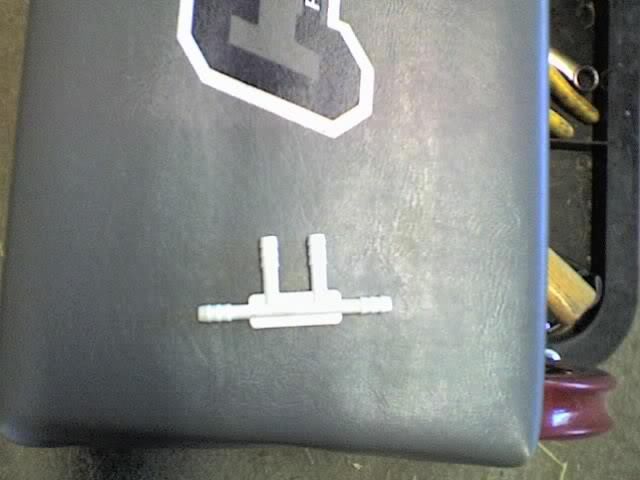

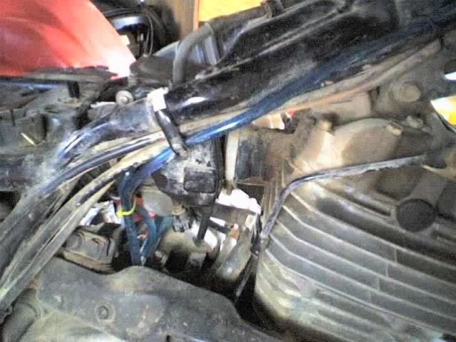

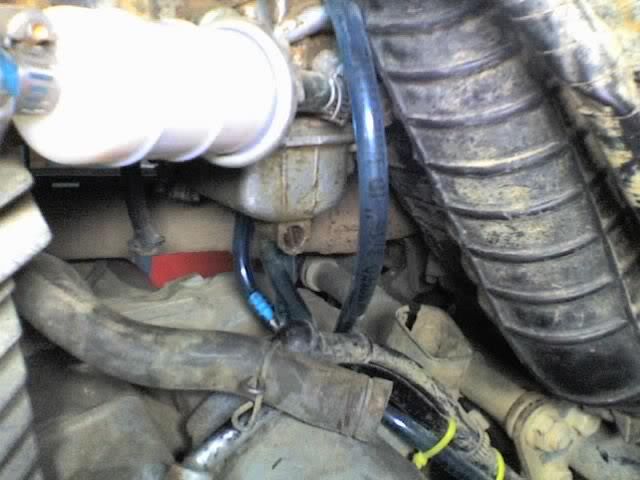

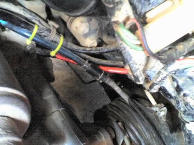

    Ok, here goes. The trike is DIRTY, I know, but you'll get picture.
    I used 3/16" hose, and a 5 way vacuum "T" connector, the one in the pic is a 4 way (obviously, hehe).
    I placed the 5 way under the carb, and ran the 2 float overflow tubes to it and the float drain hose to it. I ran 1 hose down and it has a 1 way valve on it to let stuff out but not in. I robbed that valve off of my dad's 300 Fourtrax. I ran the other tube up to the handlebars.
    On the top tube I put a fuel filter. The reason, I guess is so no dirt/dust can work it's way down.
    So, if gas needs drained, it goes out the valve at the bottom. If the carb needs vented, then the air is there from up above. I found out the hard way that the float overflows have to be vented, because I ran them down the frame and went creek riding. When the tips of the hoses touched the water, the trike died every time. It would not run at all, unless the choke was on, and then only for a few seconds. I figured it out, pointed em up and finished the ride. The cold weather starting is not an issue at all. Single digit weather, full choke, bump the starter.
    I am re-doing the crankcase breather. It uses 9/16" hose and the "T". I run a rubber squeeze valve (I guess that's what it's called) on the bottom tube. I'm gonna run the other up to the gooseneck too.
    1 more thing on the carb. The 'drain' spot on the right front of the carb that points straight down, I plugged it off to keep stuff from getting in there.
