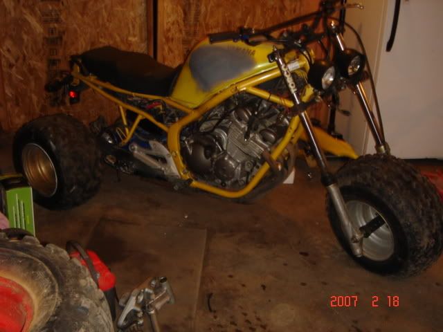

    the yellow one reminds me of a TRI-Z
    It's the same bike!!!
    Pretty cool - is it a 600cc? Bring it to the TF drags RAG!!!!!!!

    i kno that its the same bike...just reminds me of a Z in yellow.

    It's a 94 and a 96 750 crotch rocket conversion three wheeler.

    I think it looks pretty neat man! Could be a bit wider in the rear, what exactly did you use for a swingarm and stuff?

    It's got a Tecate axel with 3 inch spacers and a banshee sprocket

    nice, looks like you could use some bigger paddles on the back there.

    Yeah, thanks. I haven't gotten that far yet. What size paddles should I run?

    Some tall haulers wopuld be great!!!
    Yea the front looks like a tecate also. I take it an old tecate was used to make this new beast lol

    Yes, it was an old tecate and also a little bit of modifying with some banshee parts.
    I'll look into the haulers.

    Does anyone have any recommendations on how long I should extend the swing arm?

    +12" is pretty much a standard for bikes with serious power, that or +10".. With that bike and powerplant you may want a minimum of +12; it's actually what my bike has too

    cool, thanks

    look into some Skat-Trak taller hauler paddles, 10+ paddles.
