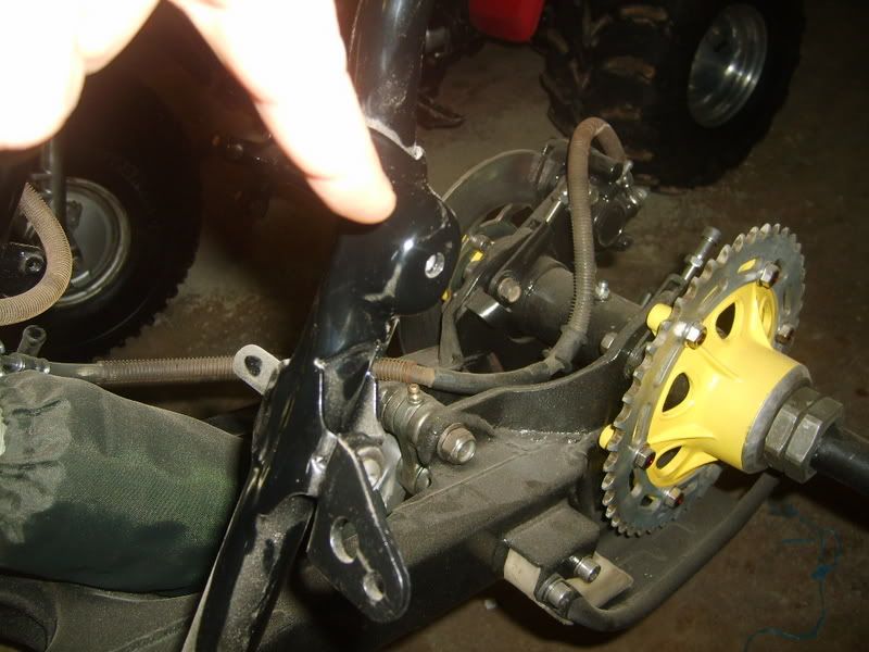

    I cannot for the life of me remember what mounted to these two spots on the back of the frame. There is one on both the left and right side.
    I'm missing the gas tank skid plate but I'm not even sure that's what would mount here.
    Yes... I know it's dusty.
    the stock silencer front mount.. there's not one on the other side,,, the hole to mount the tank pan is right above the rear master cylinder

    Hmm.. I got the other fender bracket mounted directly above the MC on the other side.. Let me go look for sure?
    does that look right? The tank was zip tied in two spots (meaning no bolts holding it in) when I bought it so I dont remember how things went.
    Since I got your attention is that rezzy hose gonna be ok routed like that?

    that fender mount need to go up to the next hole. how did you get the hose through the round hole.. I guess but its ok but the metal spring will ware your paint rubbin on it.

    Quote Originally Posted by bryan raffa View Post
    Yeah,, there were two holes in that little ,mounting bracket. One hole was rounded and stripped out so I went with the better one. I still hafta figure out what I'm going to do with that.
    for the rest of those hoses and brakelikes I picked up some 1/2 wire cover thingy... But I frear I may have to take those long springs that protect the hoses off first. idk???
