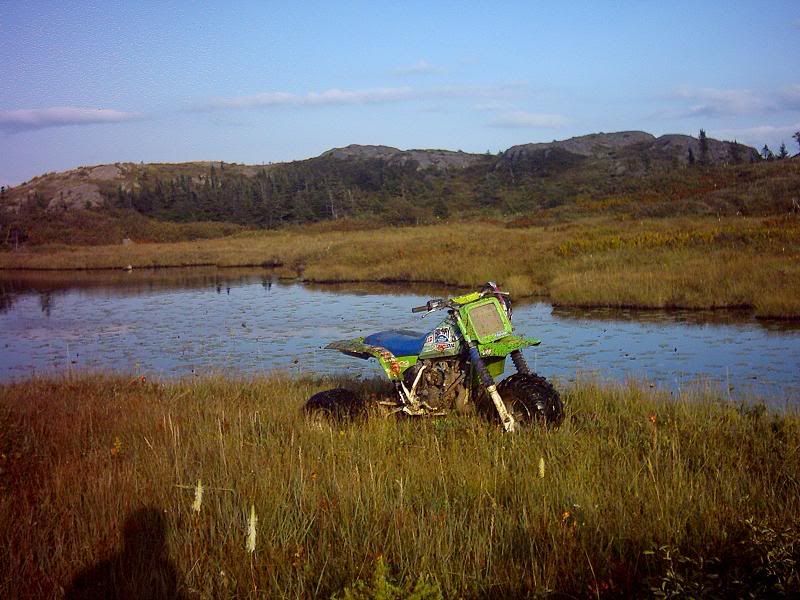

    The Tecate is whatever you make it. I've never raced mine and have it setup to trail ride.
    Its a great trail machine, goes where ever you point it. I'd run some 22 inch turf tamers if it were only going to be trail ridden and use stock gearing.
    They do great in the mud since they are so light.
    Power is incredible, scary at first with the wheel coming off the ground when you get into the throttle. Its great for trail riding because you can loft the front wheel over obstacles with a blip of the throttle. You'll get use to the power quickly and look for more like we all do. Don't need it but want it kinda deal.
    You'll have to look out for the flywheel coming apart. Best bet is to buy a Rickey Stator flywheel with the magnet pressed in instead of glued on like stock. Also go over ALL the nuts/bolts with blue loctite because they do vibrate since there is no counter balancer in the motor.
    If the Tecate your looking at is an 84/85 you will likely only pay a grand but if its the 86/87 then you will probably be paying more.
    I love my 85, its built the way I want and runs STRONG!!
