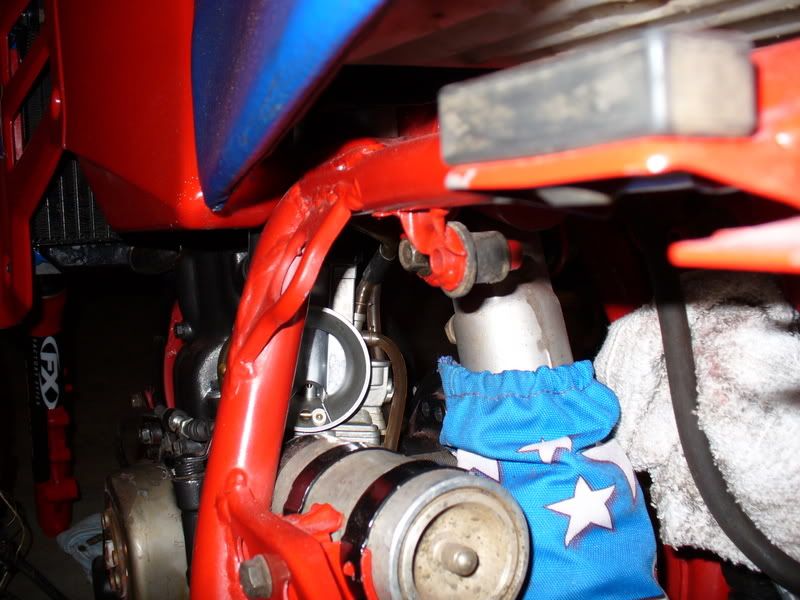

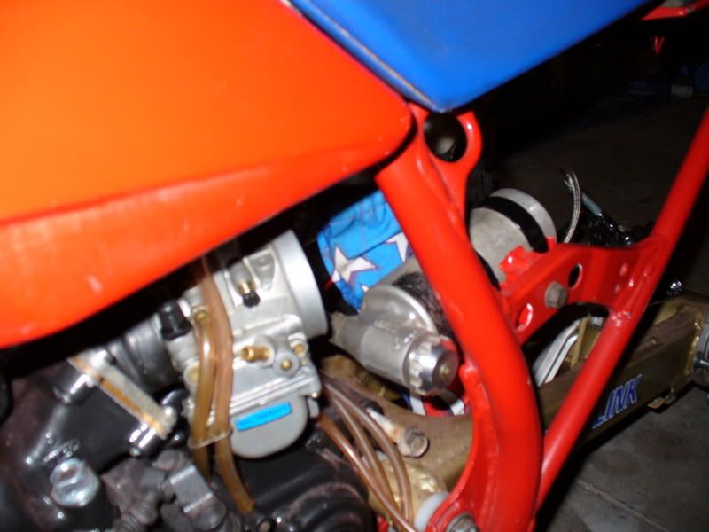

    InPiEcEs's Avatar
    InPiEcEs is offline At The Back Of The Pack Arm chair racerAt the back of the pack
    Apr 2004
    Northeast Wisconsin
    378
    Here are a couple pics of my carb/intake setup.
    I'm using a 97 or 98 CR intake, with a 38mm A/S.
    The pics make the carb angle look worse than it is.
    Basically, if you run a straightedge off the carb throat, it comes into the frame tube about 3/8".
    I may have to weld up an anlged tube to come off the carb or something..........I'm not sure.
    The stock intake is a bit better, but doesn't have the stuffer to match up to the CR reed cage, so I'm not gonna use it.
