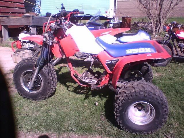

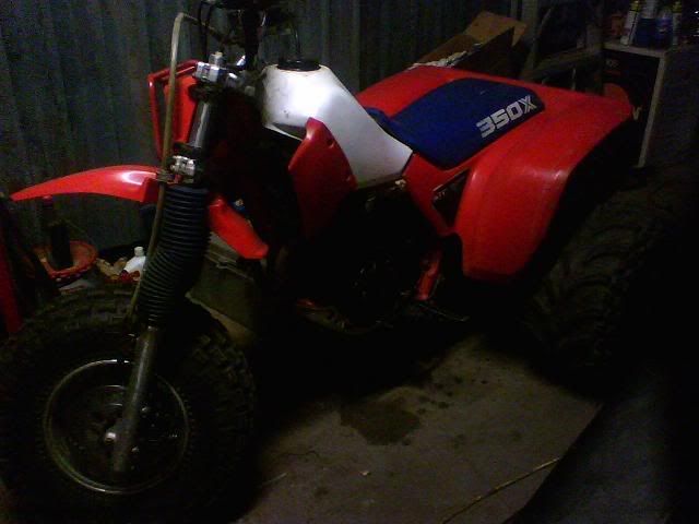

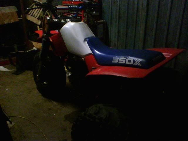

    here are some pics that i took when i had the motor out and some
    after it was dun kinda dark pics tho ill work on getting better ones
