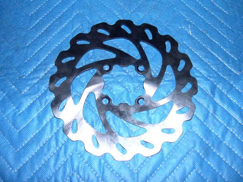

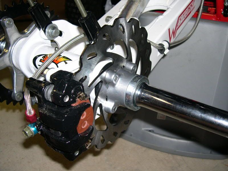

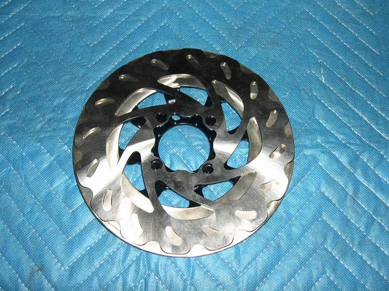

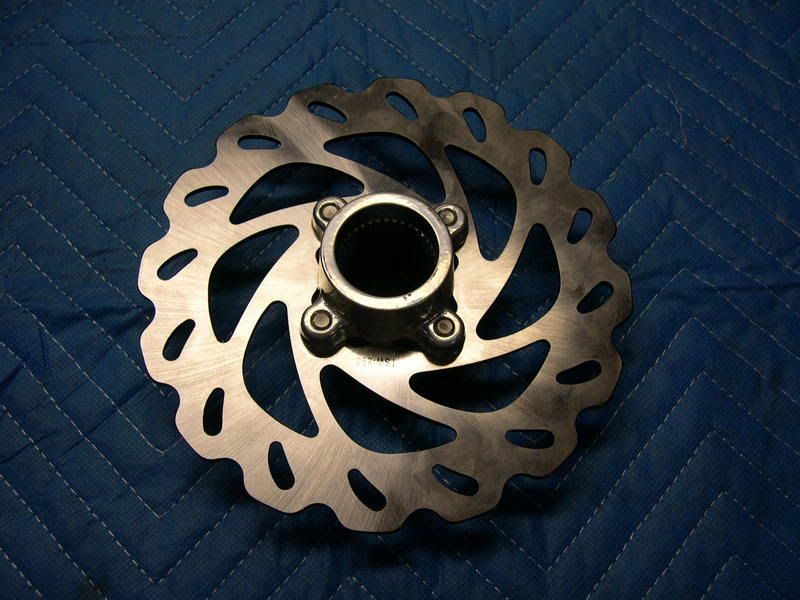

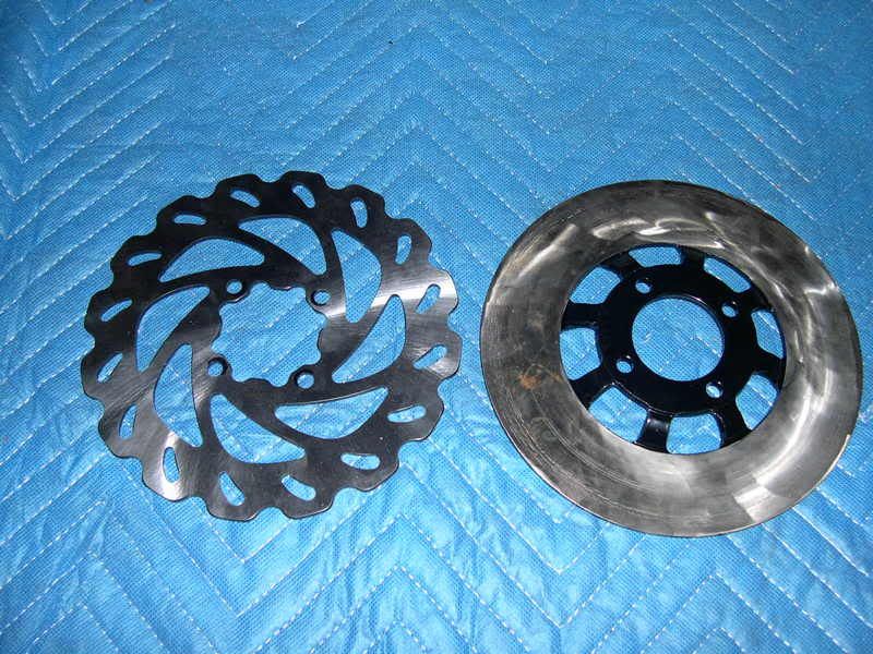

    Well this has been bullshitted about many times. Lots of guys always wondering will it work. Will it fit. MoshMan was the first to attemp and he banged it out MINT! Rob is surely no dummy on tri-z's so I bit the bullet and ordered a new TUSK wave rotor.
    Compared to stock the TUSK is just about 1/8th inch less in diameter.
    The bolt pattern is just a hair off. Minimal filing is required.
    Bolted to the stock tri-z hub
    Eyeballed up on the G-Force Banshee +4 axle.

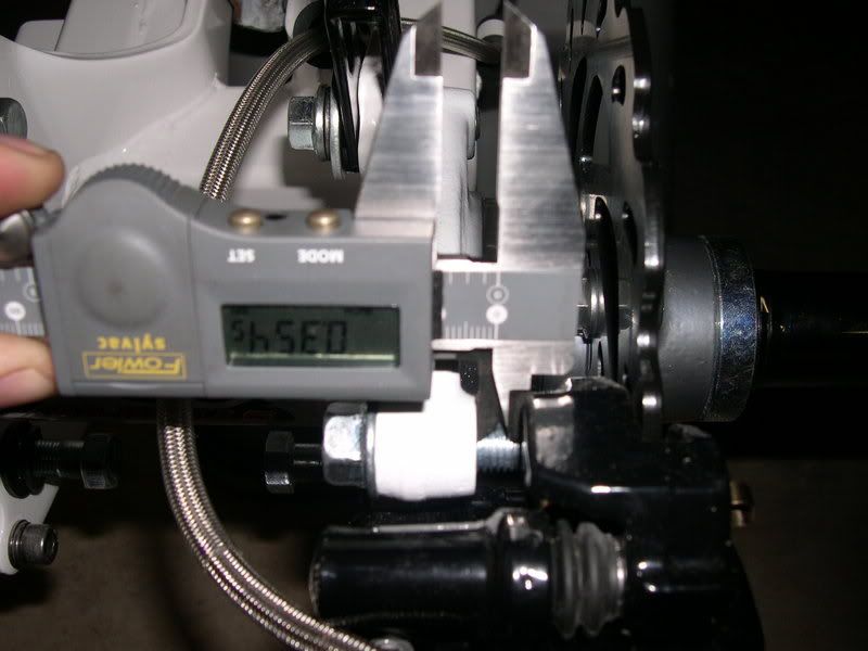

    I need to fire up the CNC and crank out some .350' spacers for the rear caliper alignment.
    What finished product should look like. Alot better than shitty looking stock.

    Awesome,it is looking good.That will also fit the front too.Some I had to file a little,others went right on.
    Hey if you make some nice stainless spacers,run me a few too,if you dont mind.
    The front is a direct swap.No spacers needed.

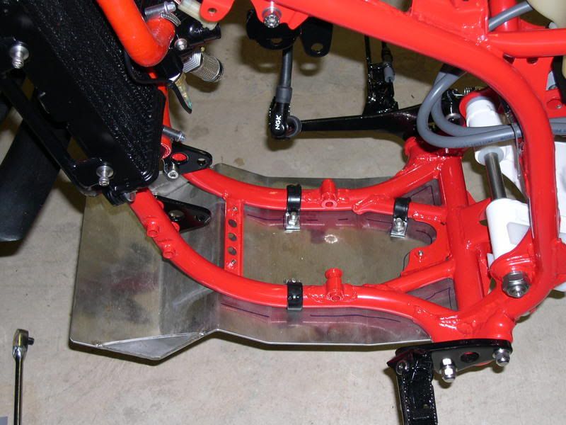

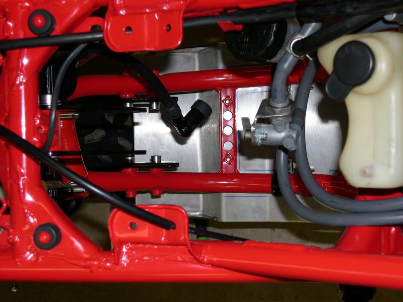

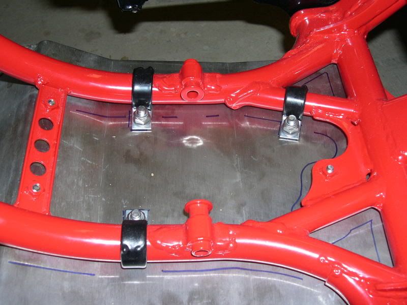

    Spent the evening mocking up my OMF "remake" skid plate for my Tri-Z. This is out of .190 stainless plate. Welded by a good buddy of mine. Really happy how it turned out. Going to powdercoat the side you see tomorrow night.

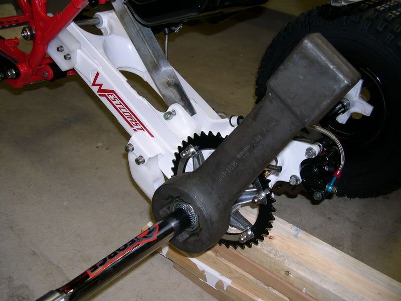

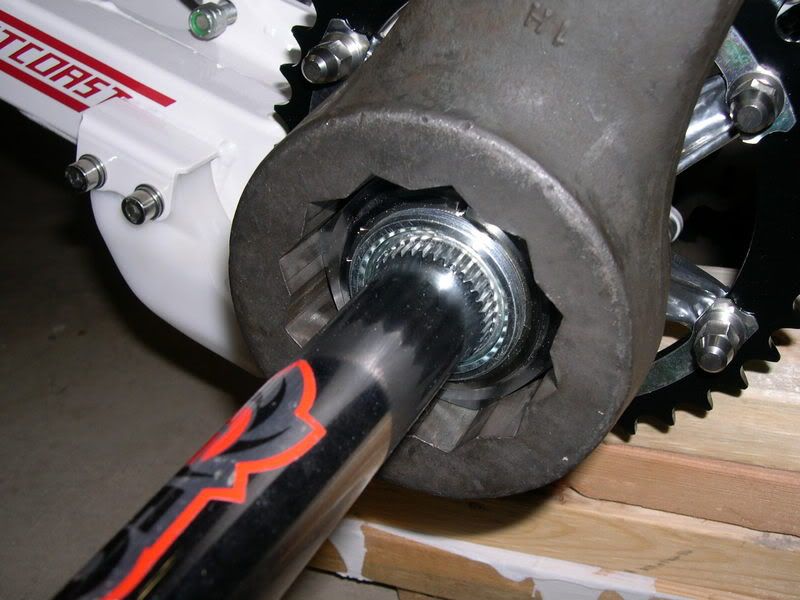

    Got the MONSTER wrench in today's mail. Wow totally impressed. Cost me more to ship then to buy off ebay. $9.99 auction. $11.00 shipping. Haha. Worked so fantastic. Always kicks major ass to have the right tool for the job!

    Definatly comming together, slowely yet surely. I think I'm going to go with the yz490 OMF engine skid. Raffa has used them and they are close to bolting up if they arent a direct swap.
