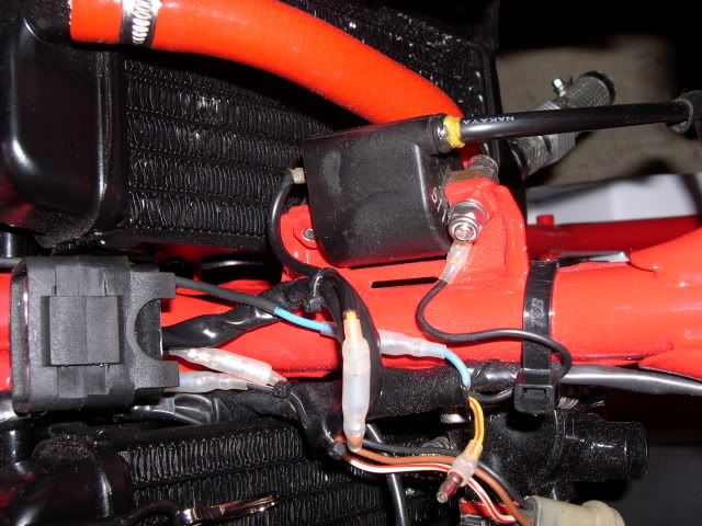

    Few questions.
    Finally nearing completion. Its WAY OVER DUE. Ya I know. Waiting and a little more waiting.
    Things yet to do:
    -Install Motor - finally done! thanks to Corey!
    -Install freshly rebuild stator from RickyStator
    -Wire lights
    -Install exhaust
    -Install chain
    -Finalize footpegs and powdercoat
    -Wire pro-design tether
    Couple of questions...
    I am running what is aparently thought to be an answer or phasefive racing pipe. I am for sure running a answer equalizer silencer. Is this the correct mounting position? What about this lower tab on the exhaust?

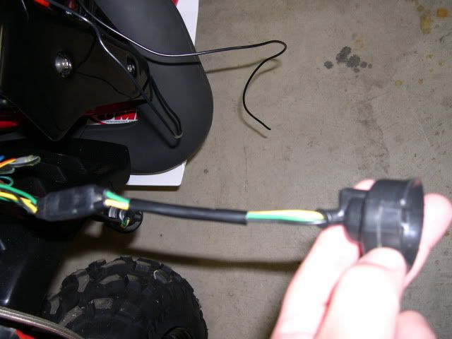

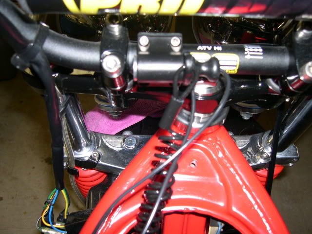

    When wiring the kill switch, Pro-design states, the short wire goes to chassis ground. Where is chassis ground on a tri-z? Also, connect the long wire to the positive side on the ignition coil. One would assume the side the spark plug wire comes out is the positive side???
    Last question. The light pig tails. Which is power - hi, power -lo, ground?
  14. #344
    Jan 2005
    RI
    2,530
    for that exhaust, it looks like a dg silencer to me...I have always bought the OEM rubber mount that goes back there.
    Ground is a loop end connector that you bolt where the igition coil mounts to on the frame.
    I think the orange wire is the positive wire, since the coil grounds to that ground loop and the frame all in one. The orange wire comes out of the cdi so i think that has to be the positive side telling when the coil to fire.
    Black is ground for the pigtails. Pull the big round cover back and the one wire that does not go to the bulb socket is the ground. I forget which one is high/low at the moment, let me go check.
    IF YOU READ THE FING MANUAL you would know that yellow is high, green is low, and black is ground.
