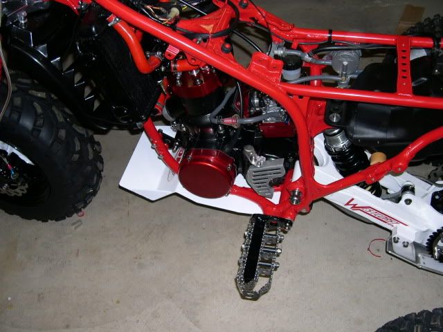

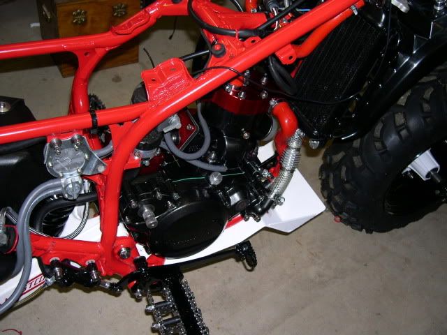

    Had Jim , Userj8670 came over and helped me get the motor in tonight.
    Is it ever finished!

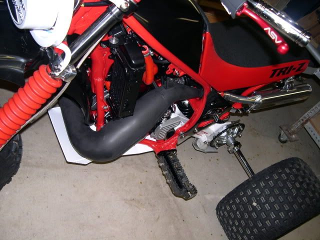

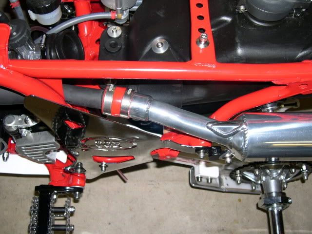

    Spent some time mounting up the exhaust. The more and more I think about this pipe. It doesnt look like a phase five. It looks like a Johnny's speed and chrome pipe. This comes after a long night of reading and scoping out old 3 wheeler mags. Anyhow it mounted up great with new OEM exhaust gaskets and 3 new OEM springs. Boy were those a real to get on.
    Because this is an pieced together exhaust setup I had no idea how to seal the joint between the pipe and silencer. I didnt want to spend the cash on the OEM setup cause I was unaware of its size. So I measured the pipe and the silencer both being a diameter of 34MM. So I ordered a 3 inch section of 34MM silicone hose, good to 500 degrees and a couple of stainless clamps from some place on ebay in hongkong. 3 days later it was here. Worked the cats ass!!

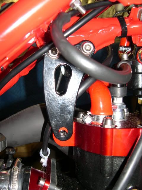

    After getting the engine in and all of the mounting bolts in I bolted up the top mounts to find this.
    Now not only do the not line up, there is a gap on one side of the mount and nothing on the other. This really blows. Now I have to make a custom set of top mounts just to secure the headstay portion of the motor. Anyone elase have this issue???
