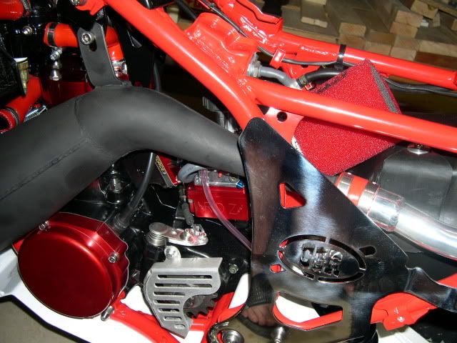

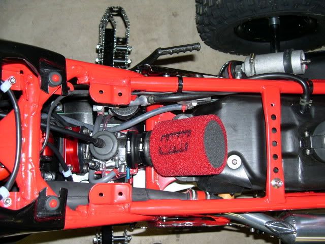

    I have something bigger and better planned for this air intake but I am waiting on some parts to make it happen. In the mean time I have devised this. I used the stock airbox boot but reversed it. The problem with running a PWK 39MM is that the bell is 2.4375 or 62MM. Not many air filters fit it and forget about buying any silicone adaptors to fit it. Oddly enough the stock boot fits it like a glove when reversed. Leaving the other side 2.250 or 57MM. From there I used a piece of 16 guage 304 stainless exhaust pipe 1.250 in length to adapt a UNI filter on. It fits perfectly under the seat. Just need to relocate the overflow bottle now.

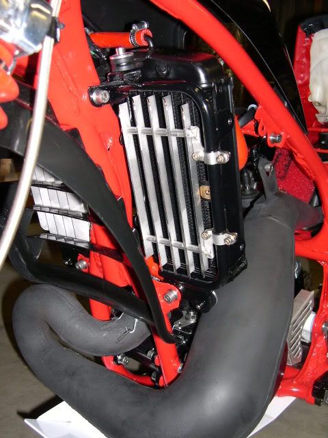

    Purchased these prototype guards from Marco / Hagen / Greenboy here on the boards. Wanted something different. Every screen/guard I bought the pins were half worn out. These look killer.

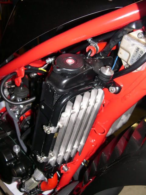

    New Radiator cap too.

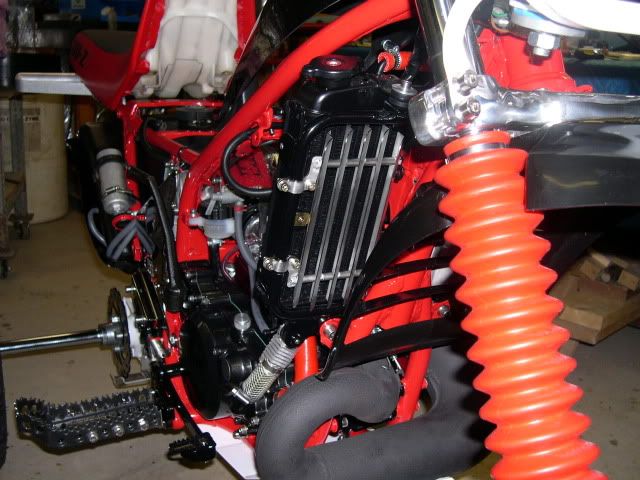

    Are OEM fork boots still available?

    That thing is looking awesome Jeff, really nice machine for sure
    The only problem I can see in those pics. is,,, I can see your damn "Man Feet" in that stainless cover!!! "Nothing worse than seeing another guys feet!!!

    no dog they are not. tanks loves the man feet.

    you wont like it when the air filter oil is all over everything.... get a outerware...
    that Chit looks tough!!!!!!!!!!!
  8. #413
    Aug 2005
    Lockport, NY
    2,395
    Good point BR I will get on it like white on rice in a snowstorm.
  9. #414
    Las Vegas, NV.
    2,510
    Looking very nice!
    Why bother if this intake setup is only temporary?
