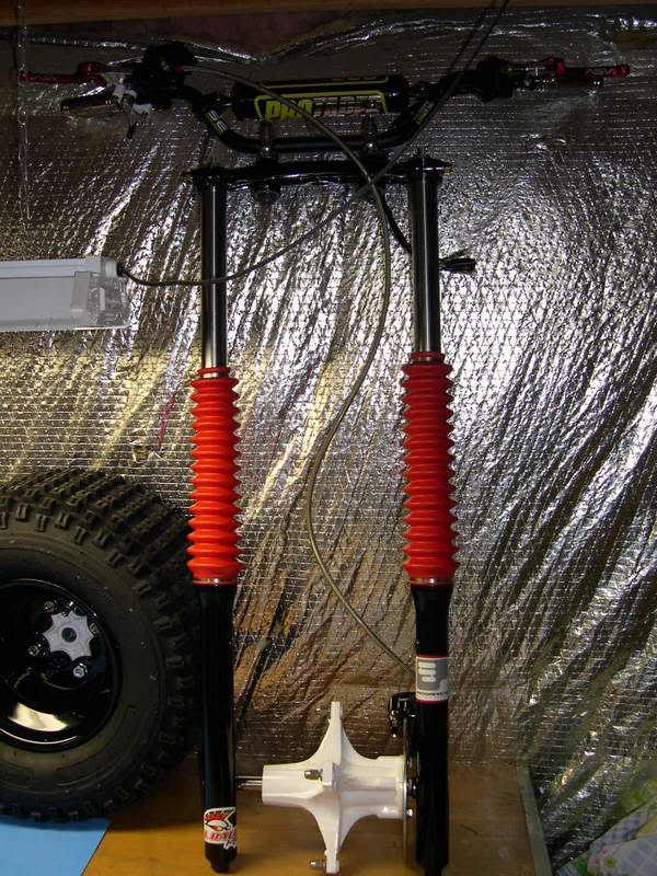

    Well finally got my rear tires and mounted them up this weekend. Went with the classic turf tamers 20x11x9 on some ITP wheels. They are 4x110mm bolt patern. The hubs I am running are the PARTS UNLIMITED Yamaha spline/Honda bolt pattern hubs (PN#144512). They are cast aluminum and run about $60 bucks a pop. I powdered these with Super Mirror white powdercoat.
    I decided to mock up the front end of the Z as well. The forks have been completely rebuilt with OEM bolts,seals, and etc. They have also been outfitted with Progressive suspension and some 15wt. BelRay fork oil. Fork legs done in epoxy gloss black powder. Front hub done in Super Mirror White powder. Front hub has ALLBALLS bearings and Ronnie's stainless nuts and washers. Also running Ronnie's front stainless axle and spacers.
    I decided to go with a G-FORCE banshee axle +4 and a PWK39 carburetor. Those will be in next week.
