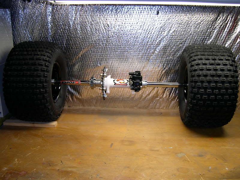

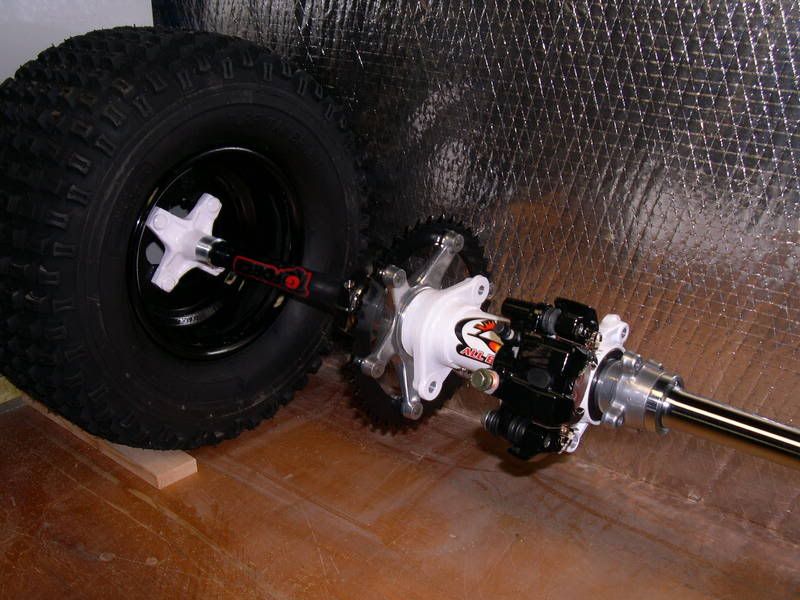

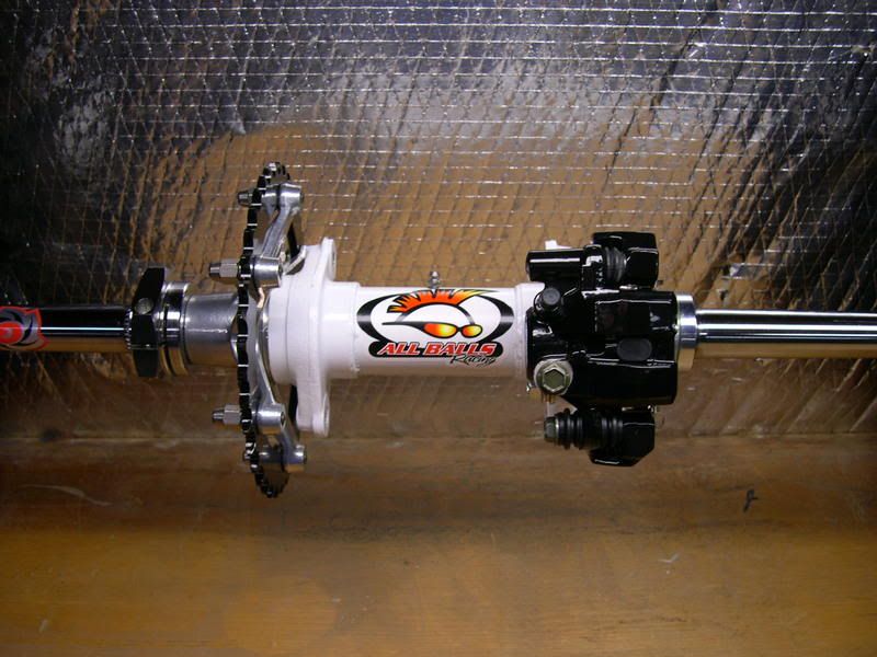

    Finally got my G-force after a screw up in shipping. Slapped some of the parts I have already redone on it to see how it looked. Looks pretty good. Stretches to about 52 inches across.

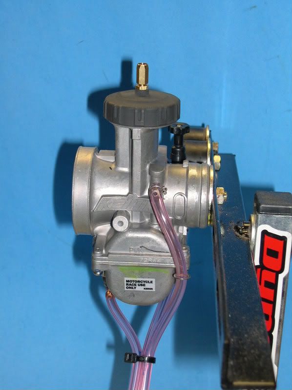

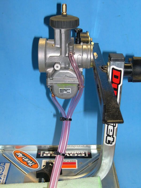

    And a couple pics of the new PWK 39mm. Wheres a good place to start jetting? High comp. dome,v-force 3, ronnies port and polish, etc.
  14. #89
    Columbia
    5,131
    Looks great man!
    Id start with a 55 pilot, and a 170 main. Im pretty sure thats about where mines at. Only difference is I gots a pump gas dome on right now.
    Finish that sucker! I cant wait to see it!
  15. #90
    springville, PA
    6,185
    I needed a 200 main, clip dropped all the way, and a 60 main to keep enough color to make me happy.
