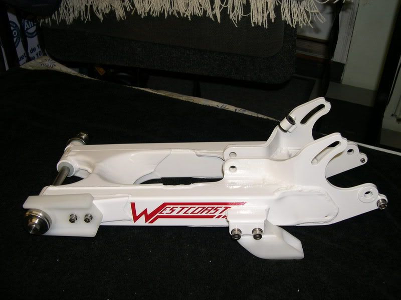

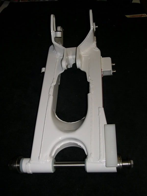

    Well I wish it was a WestCoast swinger no doubt about it. Ever since I had seen mikeinlongisland's real deal westcoast swinger I said F' it Im gunna make my stocker look like that. So here it is in Super Mirror White powdercoat. X.Systems westcoast decals and tri-z bushings. Got This Rag with ronnie's stainless caps and swinger bolt. OEM chain sliders from Yamaha and some stainless socket heads for looks. Other than that shes OEM. This will have a OMF swinger guard when Bones gets it done! Next update won't be for a while. I have to travel out of the country and by the time I get back I will have a frame ready and hope to have a roller by May.

    ahaha that looks awsome man, it would fool me

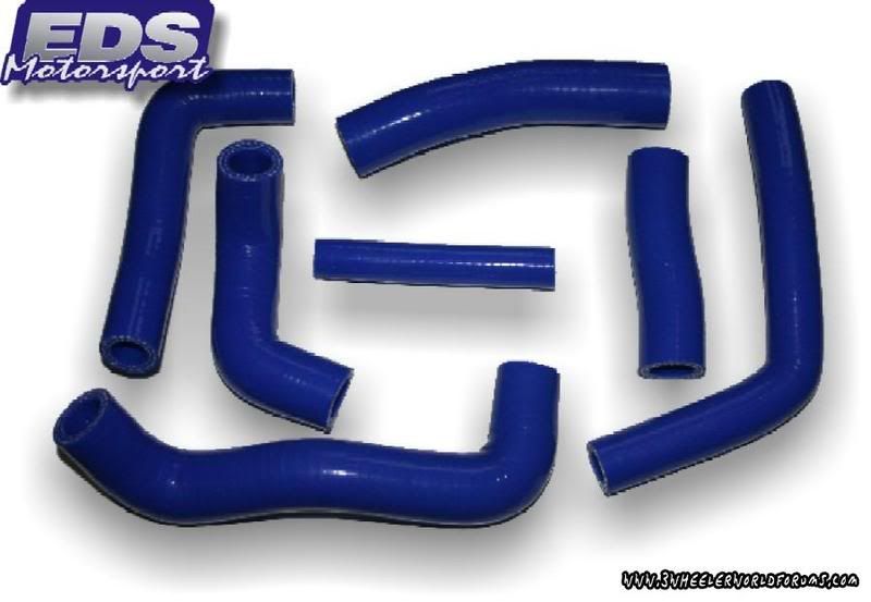

    Get em while there HOT boys! Bout time we started having all the luxuries of the Honda's. These look so great Mike! I donated my hoses months ago to Mike's efforts at E.D.S Motorsports in the U.K. If you have seen his work on the ATC 250Rs its top notch. These will look SICK with the new MOSH's blue plastics!!!!!!
    Forget that! yellow hoses on an All yellow Z . Yellow and chrome here I come . Thanks for taking the effort

    whatever color combo you desire wheeliepop!

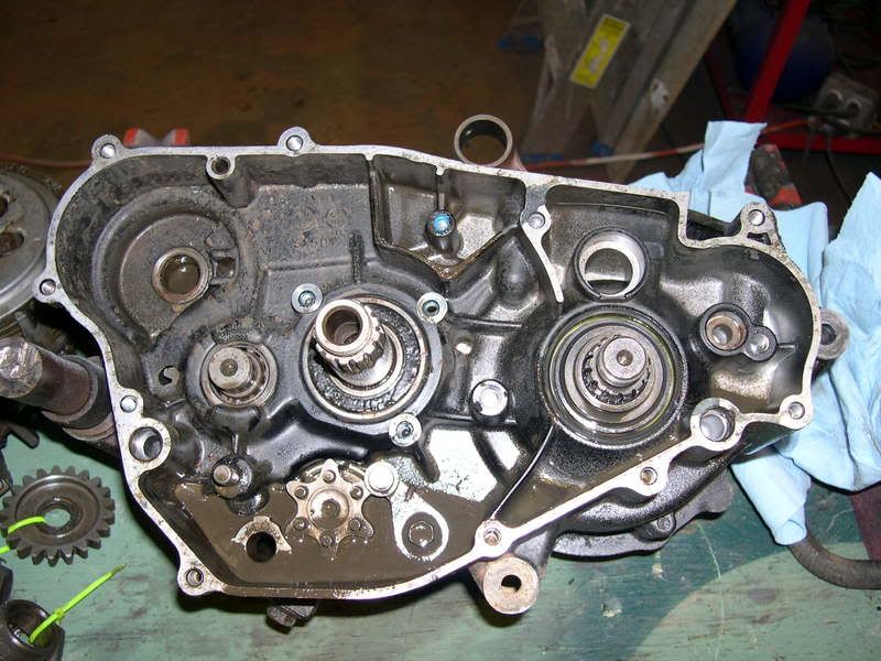

    Had some spare time to get into the tri-z engine this weekend. Sure glad I did. This engine has had some water in it for sometime. It does appear to have had the waterpump gear and mechanical seal changed recently. After removing the clutch and everything else related to that side of the engine. I was able to drill some holes in the plywood I had between sawhorses and lay the engine flat. I then took a Razrblade grinding disc and cut off the swinger bolt that was frozen in the cases. I was then able to drive out the pin that was frozen in. It got even better when i split the cases. The tranny was completely encased in sludge and grime. Either way oh well. This will get all new OEM bearings and seals. Not the ebay bargain bearings and no name seal kits. Anyone who is familar with yamaha knows they run teflon around the sealing surface of the seals. Tranny shafts and gears look good. They will get cleaned up in a sandblaster that i use walnut shells in. Much for forgiving on delicate parts . Frame will be back tomorrow from powdercoat and then its only a matter of time before there will be a roller!!!!

    Wow thats nasty!
    Hurry up man I wants more pics!
