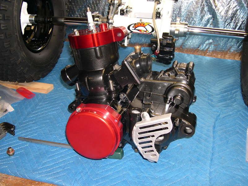

    Eric in due time my friend. The engine will be a while. I have a ton of parts on order @ the dealer I work at. I have seen to many guys "rebuild" motors and not do what needs to be done. They figure one bottom end for every two top ends. This motor was on 68.50. Which is the second run for the bottom end. She is definetly tired. All the sealed bearings had signifact bubbling on the seals themselves, which means one thing RUST! Crank bearings didnt seem to terribly bad. But whats the point of spliting the case and not changing them. This wont be a whine and complain thread when I have a cosmetically good looking bike with a junk motor because I didn't take the time to do it RIGHT!

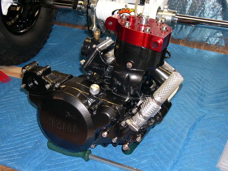

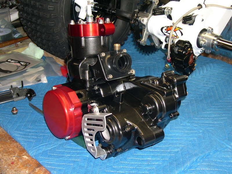

    Fresh outta the MF'ing' oven man! This is what the motor looks like mocked up. Color is Gunmetal grey metallic from columbia coatings in tennessee. Boy is this thing sharp to the eye in the sun! God I cant wait to get this thing together! No expense spared yet again. All OEM in the bottom. Crank will get trued up with a new rod and the pin tig welded in. Hope to be able to keep a wine glass on the seat LOL. Just teaser I had an early day from work and couldn't wait to finish powdercoating her!

    Turf Tamers FTW! That rear is nice!

    Looking sweet man. Looks like that motor will be fun.

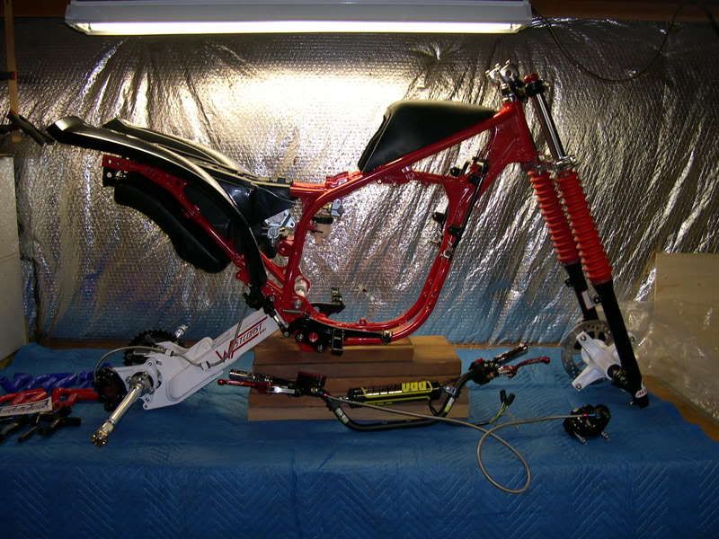

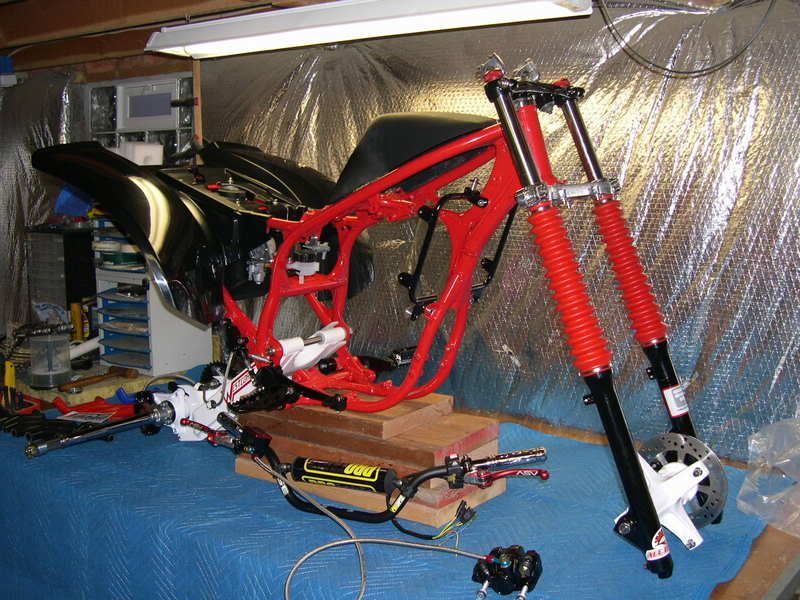

    Well got my frame back and took two days off of work to play! Started putting her together tonight.
    First sets are in the STATES!!!!!

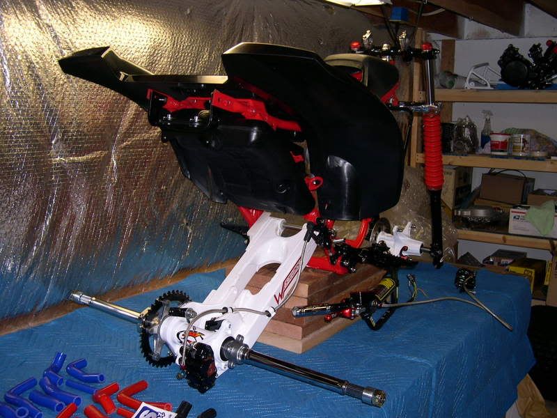

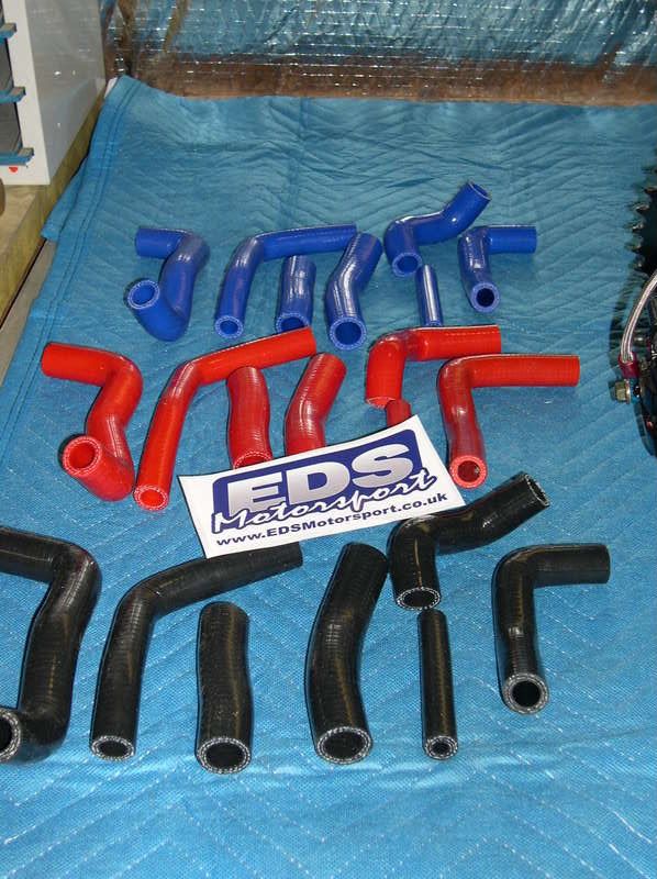

    Late night again working on the wheeler. Got rad's installed and plumbed with new silicone hoses. They do require some triming as they are not "perfect" length's but do fit nicely. I recommend for anyone buying the hoses to inquire about Mike's worm clamps he offers. They work nice! Waiting on OEM suspension shock bolts to install the shock and dogbone assembly. Front tire came in and need to get front wheel powdercoated this weekend. Not far from a roller. But a ways before shes done.

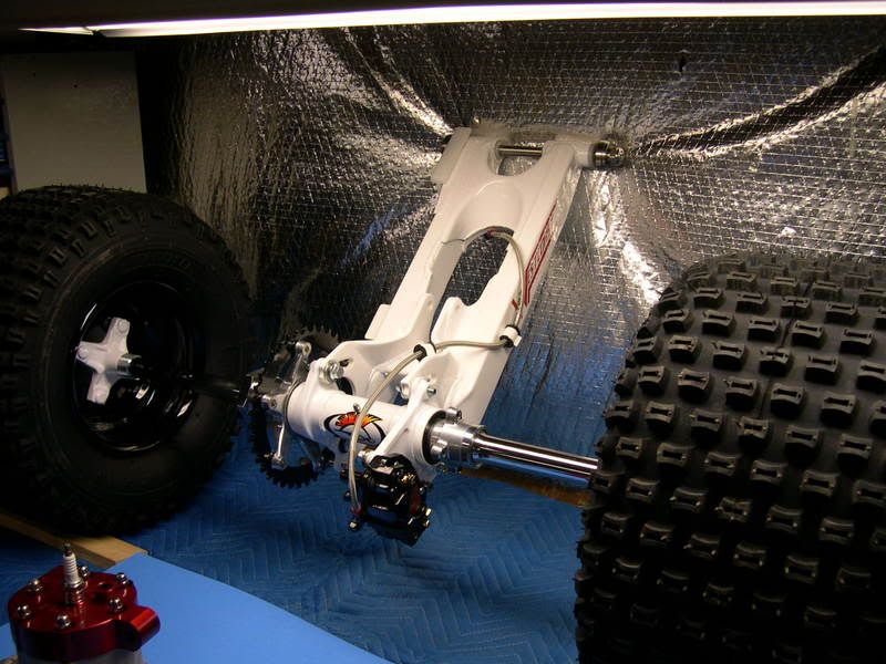

    Thanks for the compliments guys...Didn't get much done today other than powdercoating the front rim super mirror black and mounting the new 489 tire i got for the front 23 incher instead of 25. Looks sharp with the blacked out wheels and white hubs.
