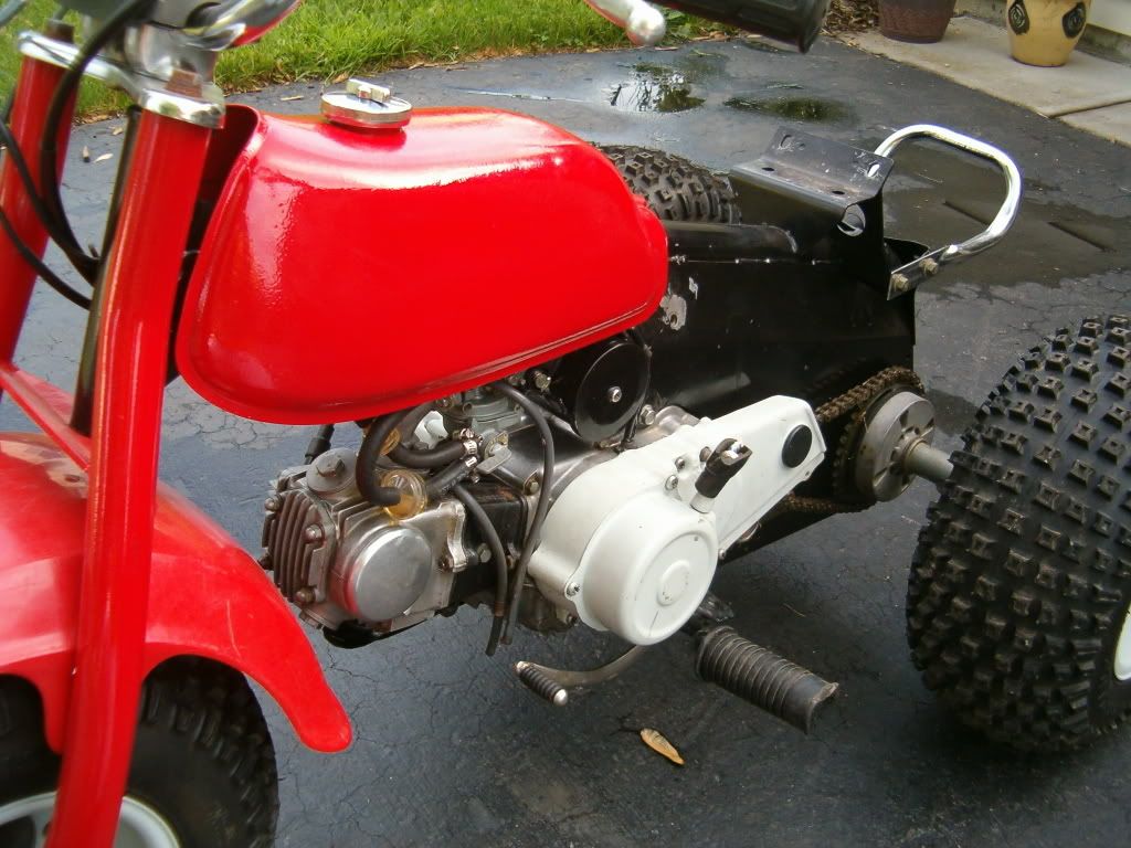

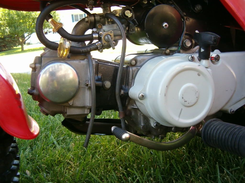

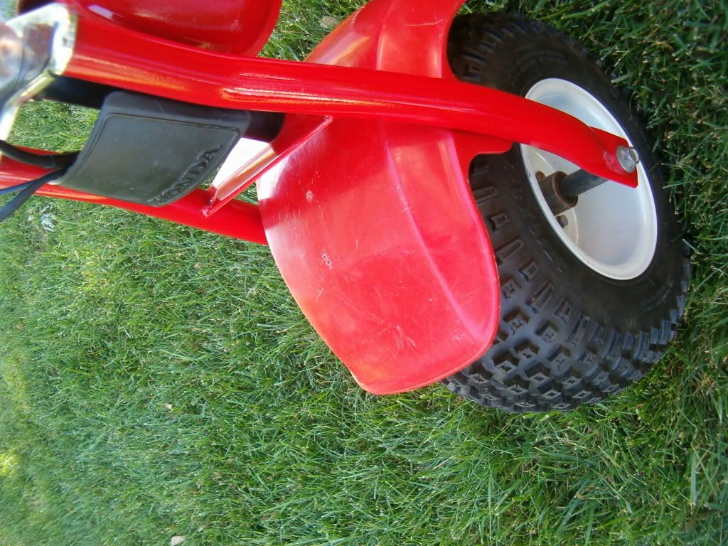

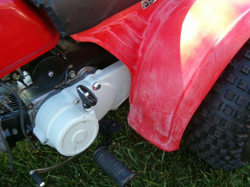

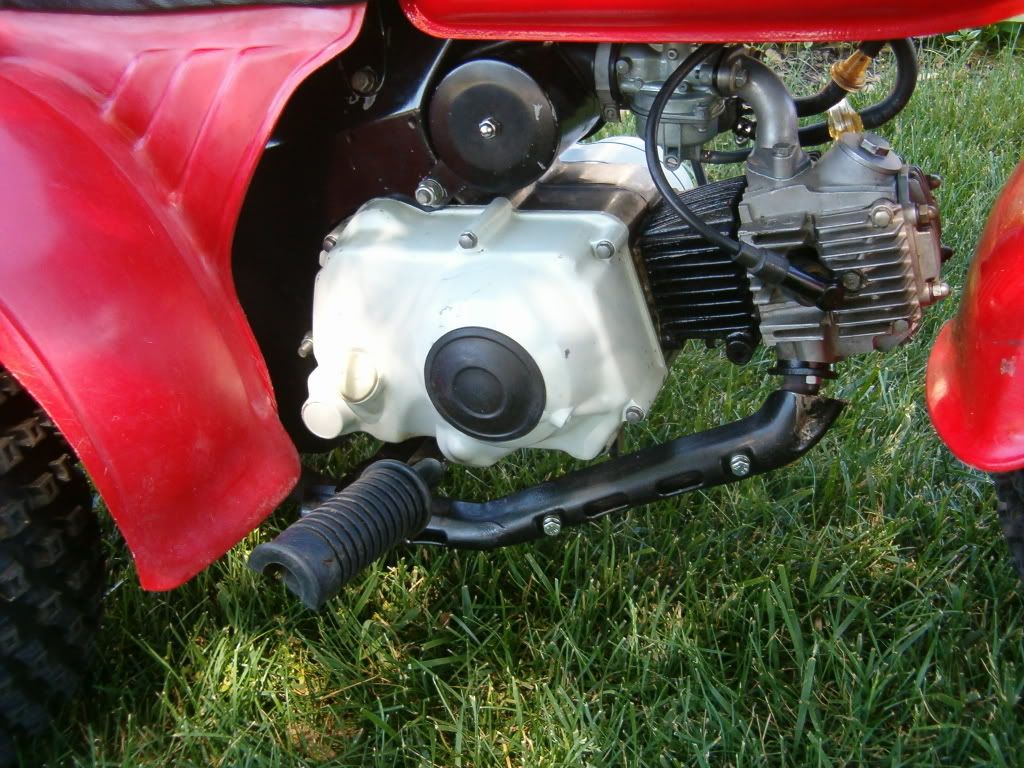

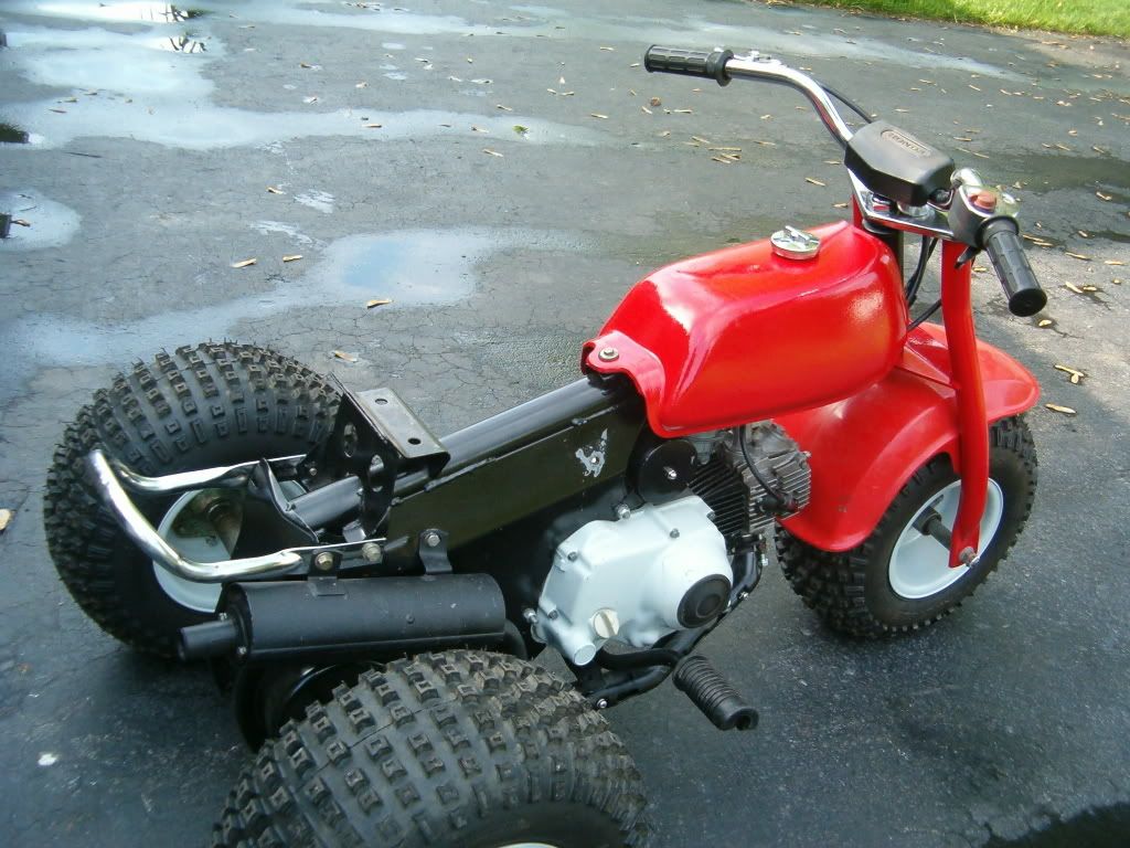

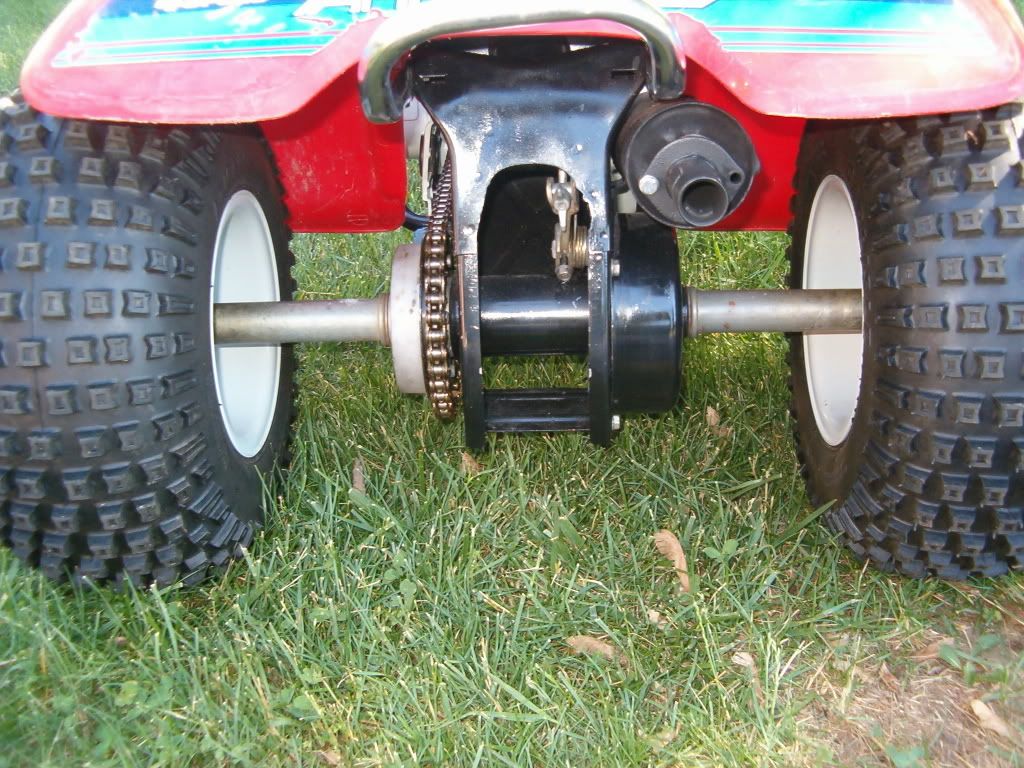

    Now that I have some time to sit and type I might as well share my summer project. I have been missing the little atc 70 I sold 2 years ago so back in May when I saw one in the paper for $200 it was calling my name. I waited a week (I was out of town) and called, sure enough it was a project trike. When I checked it out the guy said he worked on mini bikes (he had at least 6 in the garage) and that he didn’t want to mess with the trike, I offered $150 and he helped me load it up.
    I wish I had the before pictures here but I don’t you will have to wait till it is done to see them . Anyways it wasn’t in too bad of shape, all 3 tires were dry rotted to the point that I could put my hand through the cracks in them, the electrical was a mess and the tank was a rusted out xr75 tank. Other then that it looked like it sat in a barn for 10 years . I was excited having a 70 again so I went to work with the electrical. After wiring up a kill switch I was able to get it running, sort of. It ran very rough for about 5 seconds and wouldn’t rev, but I heard it run!
    Now for what you want, the pictures! This is what took me June and July, I then switched over to repainting my bike and replacing the transmission on my car. The 70 will be completed next spring. I have a tank that needs to be painted and I think I will paint the fenders as well, then I have to get the electrical working again, the spark is very weak and inconsistent. It's getting close.
    I have used….
    black appliance epoxy spray paint (ACE brand)
    light gray spray paint (ACE brand I think)
    GM super Red (2 part NAPA auto paint and a clear coat)
    Hi-temp black for the head and exhaust (don’t remember the brand)
    Caswell Zinc plating kit for the bolts
    Attached Thumbnails Attached Thumbnails PICT0001.JPG   PICT0026.JPG   PICT0032.JPG   PICT0024.JPG   PICT0029.JPG   PICT0030.JPG

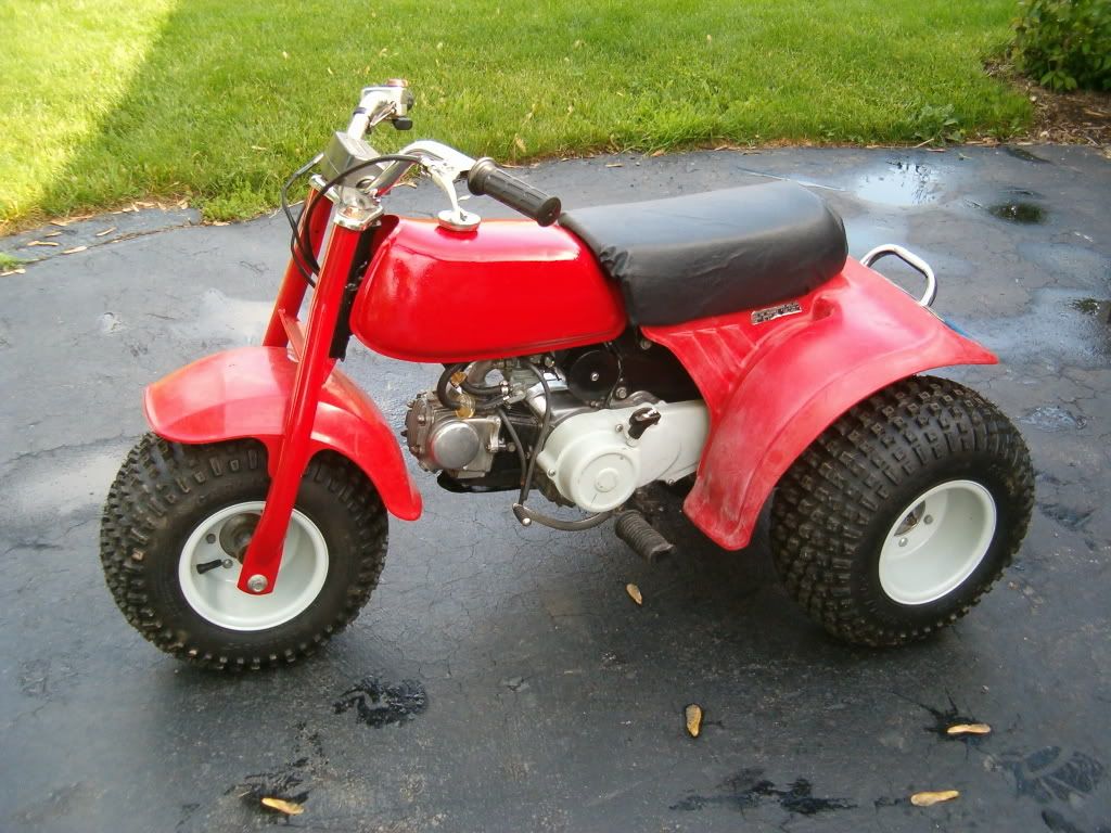

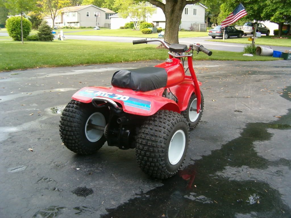

    As it sits now....

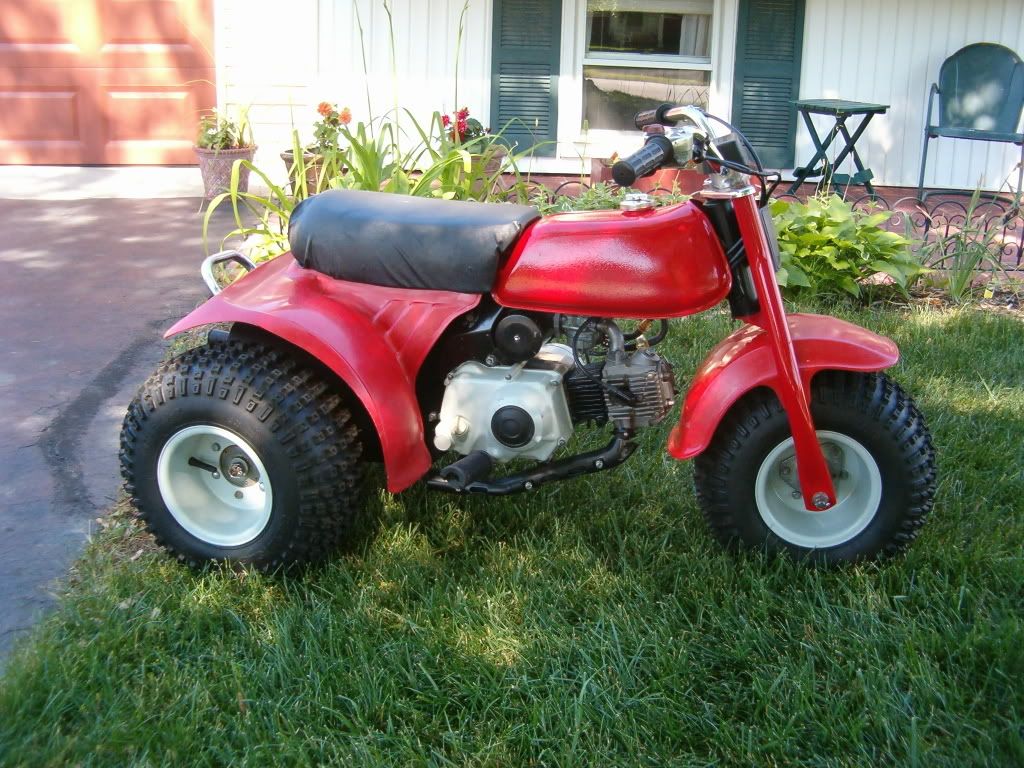

    I’m calling this project done. It starts right up, idels smoothly and runs well. I fixed the plug hole and put in the new carb needle which did the trick.
    New parts
    3 tires
    Full carb rebuild kit
    Cam chain
    Points / condenser
    Piston / rings (stock bore)
    Air filter
    Drive chain
    *Edit* Here is a short video. I pulled it out and it started on the second pull but my dad didn't get the camera started, so for the video it started on the 1st pull still cold.
    http://www.youtube.com/watch?v=VKWoOpz5kNM
    Too bad I don’t have the room for it so it will probably be listed for sale shortly…..
    Someone sanded the fenders, the back still needs some polishing.
    I do still need to weld another nut inside that muffer.....
