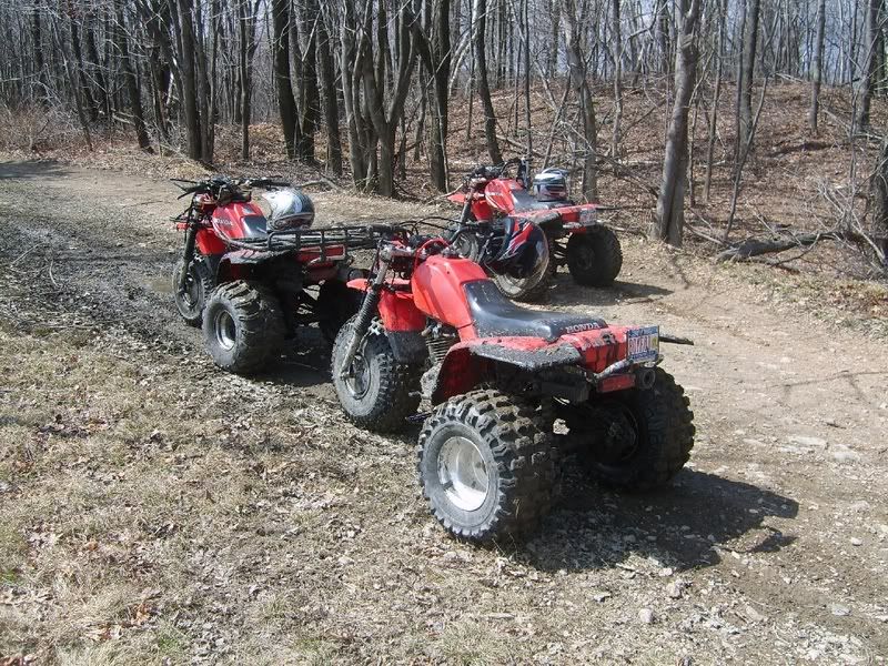

    either one is a good mudder. i had a 200s i used to mud with. so id say take that 200m but some 25 inch swamp fox tires on and you will be doing some mudding very well. ive only got mine stuck once and that was in mud that went up past my rear grab bar. took us 2 hours to get out of the mess. but other than that the swamp fox tires treated me pretty good.

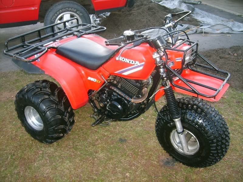

    Best trail/mud machine is the 250sx. IMO
    Oh, those mudlites ain't too bad niether.

    Hey Chris you should know those maxxis all taks on little johns SX work pretty good in mud also, my sx has wooly boogers and worked great going through the clayment at trikefest. Just changed my rear tires to spider tracks 22x12.5x8 on new steel ITP rims they hit the rear brake arm so will be needing some 1.5 inch wheel spacers, Can't wait to try them out.
