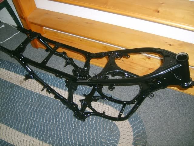

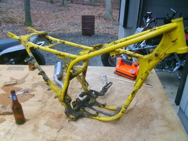

    PC can vary in price depending on who does it. Usually around $150-250... Mine was kinda spendy ($250) but I had a few busted bolts and old bearing races that had to be taken care of beforehand. I'm happy with the outcome though.
    Before:
    After:
