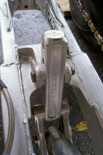

    BR, I Have raced Banshee's in the past and when i saw the Tri Z rear end i recognized parts... I replaced the stock Z dog bone with a Stock Banshee one and dropped the rear to what i think is perfect, A I also mounted up a pair of 16' american racer tires, most are 18' but these 16' are pretty neat. The Stock Z rear dog bone is 1 5/8''s center hole to center hole, while the stock banshee part is 3''..
    yes you are correct your on the right path! them 16'' tires gotta look slick..
    Heres the one I use for drag racing,, both my ice bikes will have these the center hole is stock banshee length..as you can see Im more than stock length.
