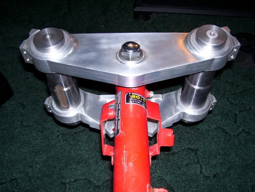

    Honda Hrc 450rr
    HONDA HRC 450RR

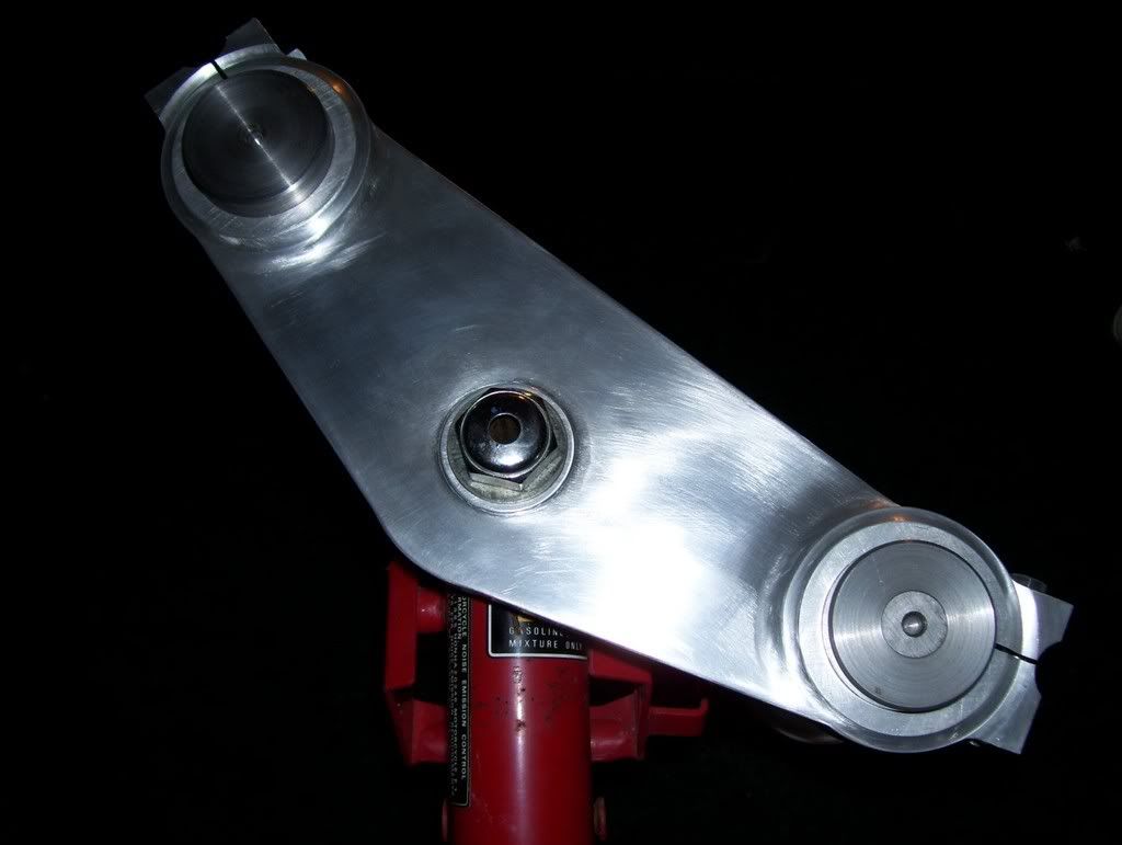

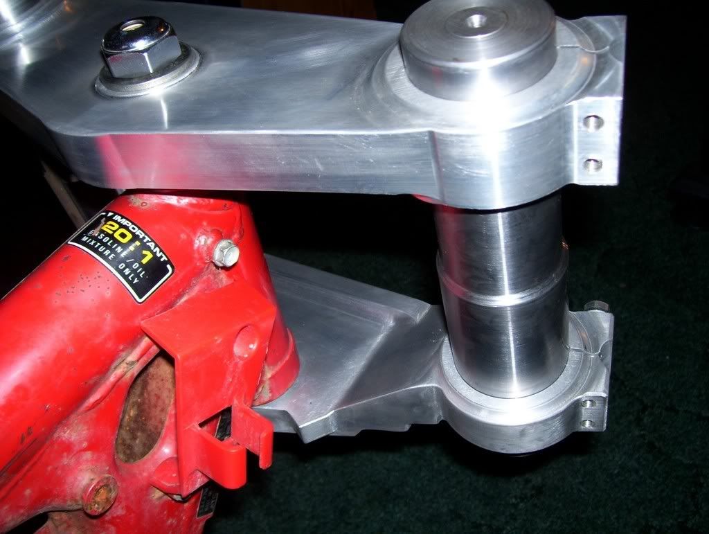

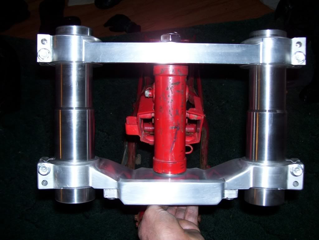

    Right, here you go,,,, these are the new billet triples, as you can see they are not totally finished, i still have a bit of machining to do for the trx 450 handle bar clamps, but that will not take long. These a practically an exact copy of the OEM triples, ie - rake is built into them.
    That's about it for the moment.

    Your wife has really sexy hands
    They look really slick and nasty!! You guys must have worked together a bit to engineer all the dimensions and rake I imagine... Came out really great
    We ALL can't wait to see the end product.

    Real nice, whoever machined thoes did a great job.

    Those triples did turn out real nice. I think they will compliment the bike well. I sure hope your running a trailing axle with the raked triples.
    Cant wait to see some more pics!

    Glad to see you or Jason chime in,, , ye Derrick for sure the axle will be trailing, it 's hopefully all figured out , well as much as can be before fitting and measuring ect - you know how it goes.
    The triples are'nt finished yet still got some work to do on them but thanks to Jason/his mate the hard part is done.

    Gordon and I talked alot on the phone about the triples. He knew just what he wanted, I helped relay everything to the machinist. I could'nt be at the machine shop every second, but I sure wanted to LOL. This job was kinda complicated because they were engineered as we went.
    I'm sure by looking at his work on the rest of the bike, Gordon will have those triples looking real nice. I can't wait to see It rolling.

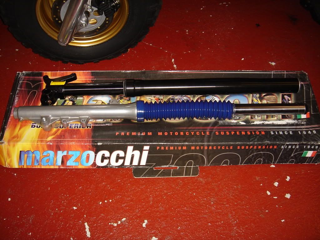

    Also, what is the model of the USD forks you are using?

    Here is the link to the shocks i have, these were shortened to the same length as the Honda OEM shocks, as you can see in the last pic post i posted.
    http://www.marzocchi.co.uk/moto/45legsx.html

    i would be very interested in the tripples if they are available and thanks for the link on the forks.
